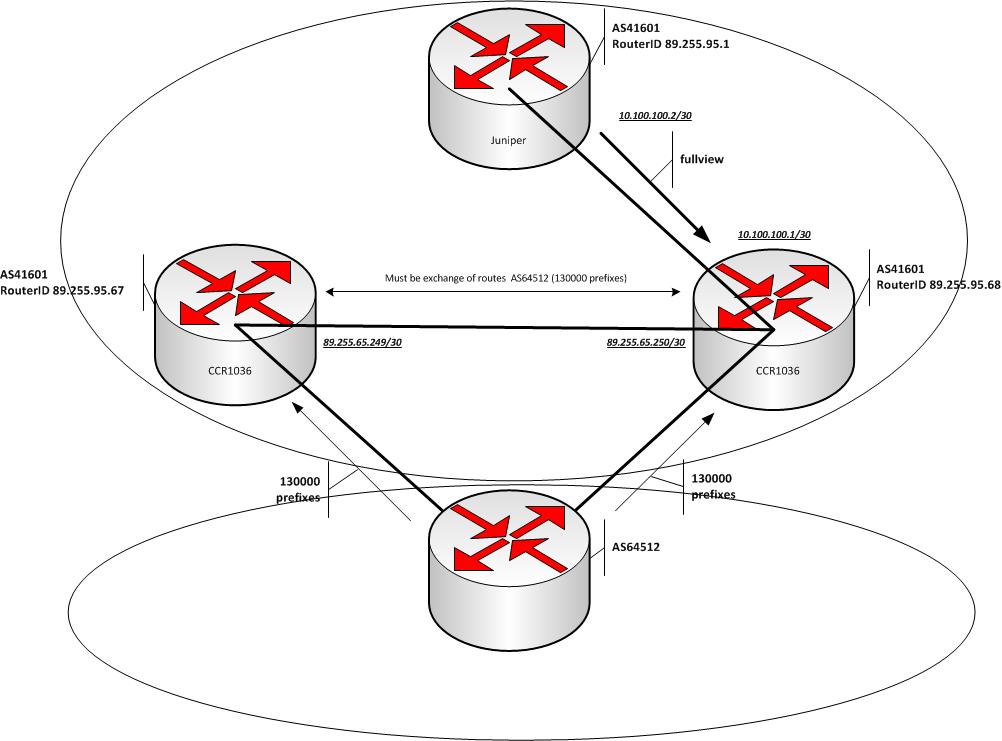

Fullview i take only one mikrotik RID 89.255.95.68 on and i don’t have to redistribute fullview to the next .
After i install two BGP sessions with other provider AS64512. He gives me 130000 prefixes to the each mikrotik.
And i have to exchange these routes between mikrotiks.
How i can do it? the problem is RID 89.255.95.68 gives fullview+AS64512 to the RID 89.255.95.67. I don’t have to give fulllview.
Roting filters don’t help me. I need help

connection by L2
There is 0.0.0.0/0 gw 89.255.95.1 in the RID 95.67. default gw can’t to create problem in it?
The connections RID67 and RID68 to side AS64512 by IP IP tunnels
Also RID67 has firmware 6.42.1 and RID68 is 6.40.3. it is normal? or it can to do problems?

Why peer IP is 10.100.100.2? Why not 89.255.65.67?
Do you have direct peering between your iBGP routers?
/routing bgp peer
add name=AS41601 remote-address=10.100.100.2 remote-as=41601 ttl=defaultWhy peer IP is 10.100.100.2? Why not 89.255.65.67?
ip =10.100.100.1 use to the RID=95.1(Juniper). it is not correct to use grey ip, but this scheme is wrong for my target?
Inside my network i have direct peering between my routers. I connect to AS64512 trough ip ip tunnel.
