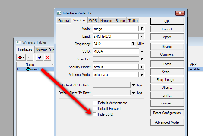

do you have this checked? you don’t need to check it, make sure it’s not checked. also make sure you are using a frequency that the clients understand
i sure it’s not checked. and im sure that im using a frequency that the clients understand
