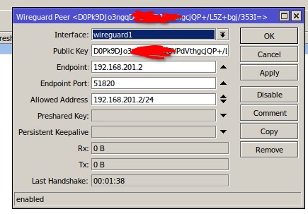

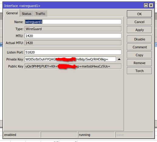

I would appreciate if I could please get some help on setting up the RB5009UG as a Wireguard server to connect with android phone.
Here is my server config:
Here is my android phone config:

What about other config on RB? Addresses, routes, … what you posted is not enough to make it work. Does wireguard1 interface have any IP address? Something like 192.168.201.1/24 perhaps? Also what you posted is wrong, there should be no endpoint for peer on RB.

I also added a bit to message, but you were too fast. Get rid of peer’s endpoint on RB.
I did. posted updated config above

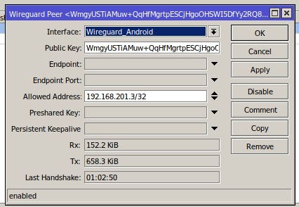

Android looks connected and tx changes all the time ( increasing ) but the rx remains at 0 all the time. I ping from android to router but I don’t receive anything. On the peer I can see this
