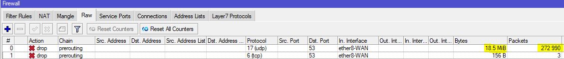

On a football and tennis campus (with around 200 mobile devices connected every day) we have a free network wifi.
My ISP provides 1gb download and 400mb upload and dynamic public ip. It turns out that my public ip changes +/- every 7 to 10 days. Our router it’s a Mikrotik rb5009.
We offer a free network wifi with symmetrical 50mb download/upload limits.
On the first or second day that the public IP changes, everything works fine, but then, from the third day onwards, the DDOS attacks begin,
which makes it almost impossible for the local network to even ping servers 1.1.1.1 or 8.8.8.8, starting to give timeouts.
I have the rule in raw,
chain=prerouting action=drop in-interface=ether8-WAN dst-port=53 log=no log-prefix="" protocol=udp
chain=prerouting action=drop in-interface=ether8-WAN dst-port=53 log=no log-prefix="" protocol=tcp
As you can see, on the last 12 hours allready hit more than 272.000 packets…
but it generates more than 1,000,000 packets in 2/3 days…
What I can do more?!?!?
I would ask for your precious help… other thing that I’m not aware of…

Yes, I know, but I have a feeling that someone knows our public ip after renew and start to hit our wan..
More than likely the issue is someone within the network is causing the issues.
Without seeing the config its hard to say if you have something missing in terms of proper security setup.
/export file=anynameyouwish ( minus router serial number, any public WANIP information, keys etc.)
This is like worrying needlessly about a trifle.
As for this request, the firewall is configured correctly, and the number of packets, if I interpreted correctly what you wrote (1000000 in 2/3 days),
is perfectly normal these days, for the moron ISPs.
If you really had a DDoS they were 1000000 per second, not 1000000 every 2/3 days (or every 12h)…
(And if you had an ISP that knows how to do its job, there wasn’t one)…
For example, in my edge router that serve more than 500 customers, i have ~250 packet every second(*) on incoming UDP connection on port 53…
So, your problem is elsewhere, it can’t be a supposed DDoS on DNS, for the numbers you write…
Follow @anav suggestion…
NOTE:
(*): Incoming unsolicited external UDP request, not counting regular DNS reply.
EDIT 1 and 3: syntax error fix.
EDIT 2: added note.
273000/12=22750
22750/60=379
379/60=6.32 packets per second (on average)
And in any case 18.5 Mb over 12 hours.
The action of dropping them shouldn’t need a large amount of resources, so large that the consequence “makes it almost impossible for the local network to even ping servers 1.1.1.1 or 8.8.8.8, starting to give timeouts”.
Maybe there is something else going on.

Thanks everyone!
I sent an email to my ISP, with screenshots of my raw rb5009 rules and the millions of packets, I got a call from tech support asking for 2 woriking days to fix this situation.
Right now, they call me again saying they have made some changes and to report them within 1 or 2 weeks.
I reset all the counters and it looks like for now they are fixed… no packets coming from raw rules… Normally I would have a few hundred in a matter of seconds… I hope my ISP has it fixed!
