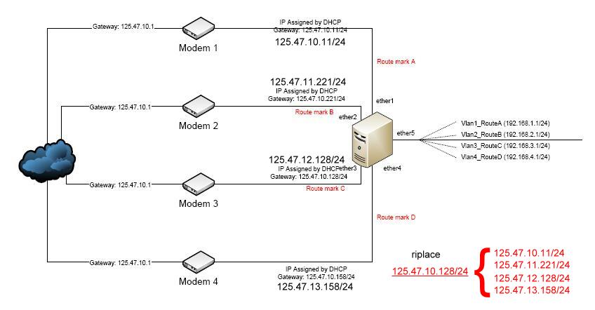

Following is the rough drawing of the network.
traffic always go thru ether1 eventhough i set the gateway interface.
note: it is now four modems with 1 same gateway, meaning i have to use 3 mini router to overcome the problems, which is pretty waste of resources here, Is there any other way please?
Thanks!
It is not possible to have the same network address on more than one interface. You must change the LAN side of the modems to provide unique address ranges to your 4 ethernet ports.
so an extra router is a must to get another set of ip to make it different from its original ip (network)?
I am intrested in this post too, i think they mean,just have to change the ip address for the LAN cards and modems
MODEM 1 LAN IP 192.168.1.1 ----> ROUTER 192.168.1.2 LAN
MODEM 2 LAN IP 192.168.2.1 ----> ROUTER 192.168.2.2 LAN
MODEM 3 LAN IP 192.168.3.1 ----> ROUTER 192.168.3.2 LAN
MODEM 4 LAN IP 192.168.4.1 ----> ROUTER 192.168.4.2 LAN
Is that correct?
That would work.

unfortunately the wan IP address is assigned by the ISP automatically, so that we could not changed the ip.
JFYI, these modems are provided by the same ISP, because of each modems are the same package plans (ie 4mbps each modem), they are set to go to 1 gateway (in this case: 125.47.10.1)
It’s meant for 1 ‘end’ from each modem, but i want to join all the modems (aka loadbalance) to gain higher bandwidth (4x 4mbps = 16mbps). And I did it successfully, but only that i have to use 3 mini router to get a new network ip, so that mikrotik can do route mark via proper interface for its gateway(s).
thanks all for the suggestions.

I did try the gateway interface feature, assigned an interface to the gateway. But the mikrotik always by default choose the interface where the ip should belongs.
say, i have this ip:
124.47.10.11/24 at interface ether1 and the gateway 124.47.10.1 (default)
124.47.10.21/24 at interface ether4 and the gateway 124.47.10.1
then i add gateway interface as ether4 for the second Ip, but it turned out the traffic is always going to ether1 because the ip address is the same (class/segment) network as the ip address of interface ether1
I marked blue on the following codes, although i assigned gateway interface as ether4, but shown as ether1 and ether 4. …
