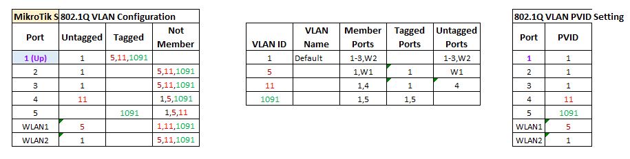

To put the long story short, I have a TP-Link Managed POE 8-ports switch already configured and tested with the VLANs is working, and I intend to use the hAP ac2 as a VLAN switch and Access Points in another room that will need to carry 4 VLAN IDs across through the trunk. What I need to set on the hAP ac2 is:
Total VLAN IDs: 1,5,11,1091
Port 1: Trunk - Tagged 5,11,1091
Port 2: Access - Untagged 1
Port 3: Access - Untagged 1
Port 4: Access - Untagged 11
Port 5: Access - Tagged 1091
WLAN1 (2.4GHz): Untagged 5
WLAN2 (5GHz): Untagged 1
802.1Q VLAN PVID Setting:
Port1: 1
Port2: 1
Port3: 1
Port4: 11
Port5: 1091
WLAN1: 5
WLAN2: 1
Attached is a diagram I am thinking of and apologize if I am using the TP-Link terms as I am more familiar with their terms.
Let me know if this is making sense and doable, I am not an expert on VLANs but like to learn and explore.

I suggest you to go with the “Router-Switch-AP (all in one)” example from the tutorial, just leave out wireless config other than config for wlan1.
Problems you’re having with the tutorial example are because your unit has two physical wireless interfaces (2.4GHz wlan1 and 5GHz wlan2). Which means that low-level wireless config from tutorial (e.g. /interface wireless add name=wlan2 ssid=GREEN master-interface=wlan1 security-profile=guest disabled=no) does not apply entirely.
When you get the setup working with 2.4GHz radio only, you can proceed to configure the 5GHz radio … if you decide to make 5GHz radio configured similarly to the 2.4GHz one (same SSIDs, same subnet membership), then you can set same configuration to wlan2 as it’s used for wlan1 … apart from RF configuration, such as frequency, channel width and similar.
