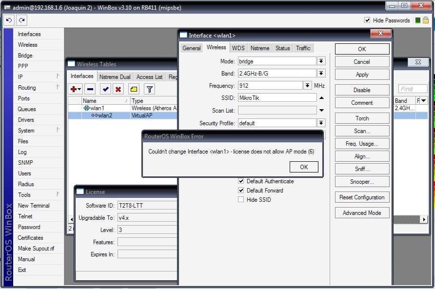

New to this and need Help on How can I obtain a Licencese key and Where to enable my RB-411R to serve as a Acess Point.

RB411R must be already shipped with L4 license that supports AP. You can find a simple AP configuration guide here: http://wiki.mikrotik.com/wiki/Making_a_simple_wireless_AP
Thanks For reply.
I’ve set up in that way but my license is a level 3
Here is a Screenshoot of RB-411 Os
How Can I upgrade two units to level 4 license and where can I buy it?
Thanks for your support
Here is a purchasing guide: http://wiki.mikrotik.com/wiki/Purchasing_a_License_for_RouterOS . Then you can paste it into the Telnet window, or License menu in Winbox.
