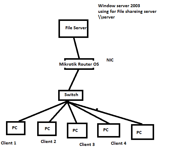

i have a File Shareing Server in which i shared big Video Files. that can be accessed by \Server
i want to limit the bandwidth of these users. so that nobody cannot copy the files more then 500 Kbps. Here is a diagram
Kindly Guide me the complete script who to configure the Mikrotik to perform such task.

File server Ip - 192.168.100.2
gateway - 192.168.100.1
in Miktrotik i just Add ip address
Eithernet 1 - 192.168.0.1/24
FTP eithernet- 192.168.100.1/24
i have no idea about Mangle and NAT and Firewall rules to perform such task.
kingly tell me what rules i have to add to access server via \server cammand on client side?
