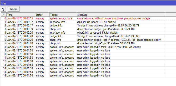

thanks for the reply. I’ve tried the bridge option but this is not working for me (most likely due to my ignorance). I’m getting an ip on the sfp1, but no ip on the vlan100. Also the ip is not propagated to the connected pc on lan port 2. Would you be willing to help me out (or would you have some scripts that i can use as an example?

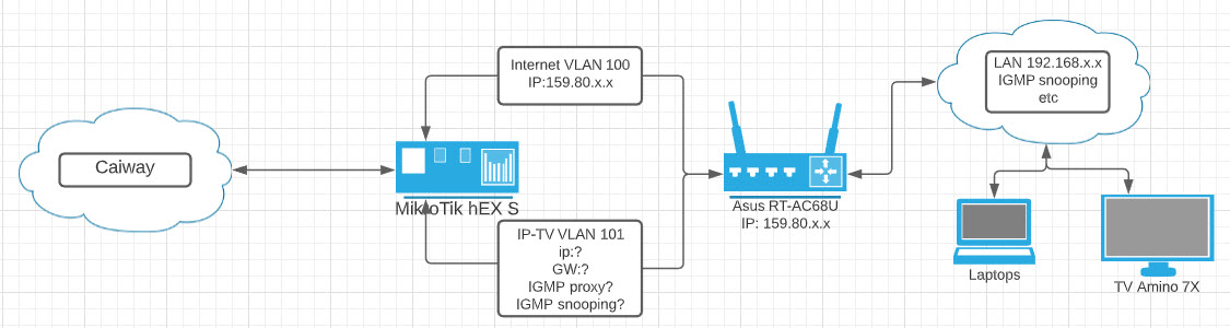

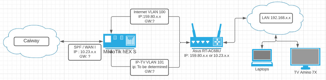

The desired target infra looks like this:

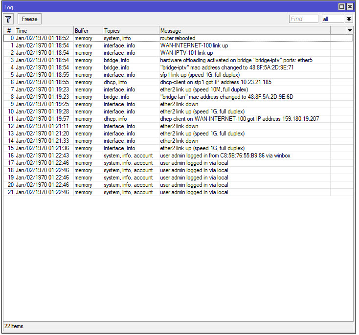

Log of the bridge solution:

So here is the current config:
As you can see i nicely get the WAN ip address and pass this on to my asus router and it works very well - however the full objective to have IPTV running over the LAN (after the Asus router/mesh network) is not yet achieved.
