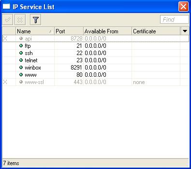

I attached image from my mikrotik just check the image and tell me wich port should i use because I tried winbox port and www. port and the both ports not work with the web proxy…
these all the ports I have in my mikrotik !!!

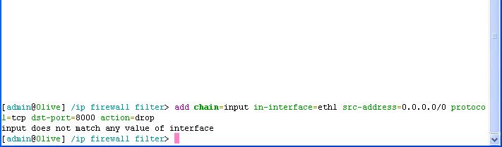

I tried but nothing happen so I attached the image shows what the problem with my router , please your response.
That says you don’t have an interface named ‘eth1’. Look at ‘/interface print’ to figure out your interface names.
