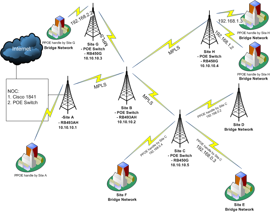

Guys,
I don't have experience in deploying MPLS and PPOE so i need your help about how to inter-connect does site using MPLS. I need help about configuration in RB450G to establish MPLS.
Site A Configuration

I should be able to hand out public IP and Class C IP in Site D,E and F via Site C.
I'm not sure about this config so please check guys.
Thanks in advance.
I’m probably missing something here, but why do you need mpls and pppoe?
Unless you’re going to run vpls or true end to end mpls I don’t think you need any of it for pppoe.
I’m just trying to make my network better, be it VPLS or MPLS and you’re right, ppoe does not need MPLS.
if you have true end to end MPLS, can i see your diagram.
I have never done VPLS or MPLS deployment so please bear with me and i have limited knowledge at the moment.
I use mpls with vpls strictly to transport things around my network. I think of it like a routeable vlan that I bridge with physical interfaces or vlans. This way my customers don’t see my network, just my edge router and that’s it.
Your mpls config looked correct just quickly looking at it.
But I think you should consider replacing RB450(G) with something else (RB2011 or something like that) because of RB450’s MTU od 1520. You need at least 1526 fall trought your network for PPPoE over VPLS.
