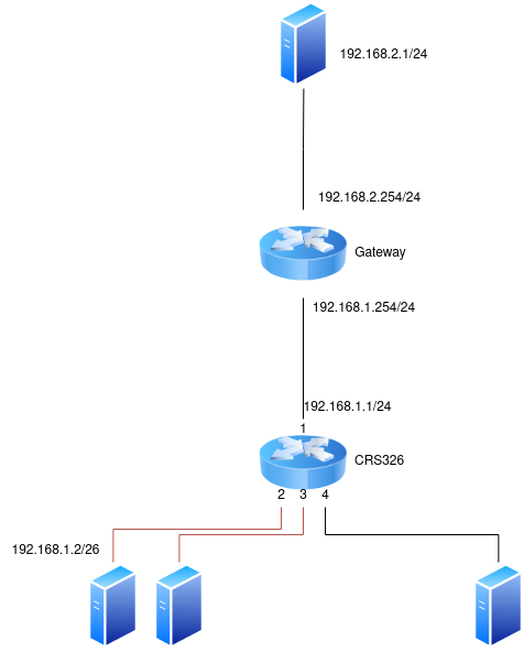

I have the setup that is shown on the attachment:
The Gateway is the default Gateway and also a DHCP server that is configured to give addresses in the 192.168.1.0/24 network, excluding the 192.168.1.1-192.168.1.100 range.
I want to have a net under the CRS326 switch (red lines) where I will have a local DHCP server (192.168.1.2/26), giving addresses on the 192.168.1.0/26 network and also hosts in that network to be accessible from 192.168.2.1.
Constraints: I do not have any access to the gateway configuration.
My initial idea is to define a VLAN with untagged ports 2,3 and tagged port 1. In that way I will limit the broadcast domain, forcing hosts on red lines to use the 192.168.1.2 DHCP server and not the Gateway one. However when I do this (following this: https://wiki.mikrotik.com/wiki/Manual:Interface/Bridge#VLAN_Example_#1_(Trunk_and_Access_Ports)), 192.168.1.2 becomes unreachable from outside (Cloud shape). From my understanding this happens because the gateway does not get an arp response from 192.168.1.2 and thus cannot find it, as they are in a different broadcast domain.

There are two ways to do vlans.
Bridge VLan FIltering method
Switch Chip method
and I think there are specific directions for the 300 series…
Check out Para O, for your best bet ( Para C is bridge vlan filtering) - https://forum.mikrotik.com/viewtopic.php?t=182373
