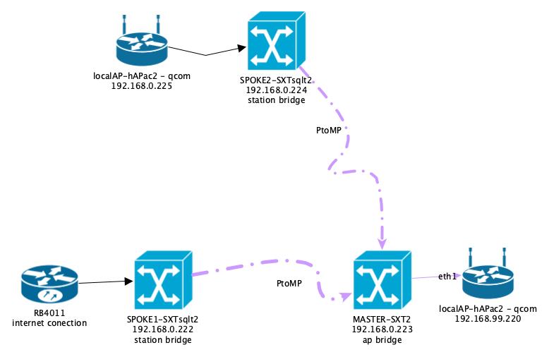

I’m trying to optimize a small Point-to-Multi-Point wireless bridge between three buildings and I’m running into stability issues.
I’m a complete beginner with wireless bridges, so I probably did several things sub-optimally and would really appreciate your feedback.
Topology
  • 3 buildings arranged roughly as a scalene triangle
  • One master / AP bridge in the central building
  • Two stations / spokes in the other buildings
  • Angle between the two spokes as seen from the master is about 18 deg
  • Distance:
    • Master ↔ S1: ~46 m
    • Master ↔ S2: ~450 m
All devices are mounted outdoors with line of sight. The link works, but the connection feels unstable and “bursty”:

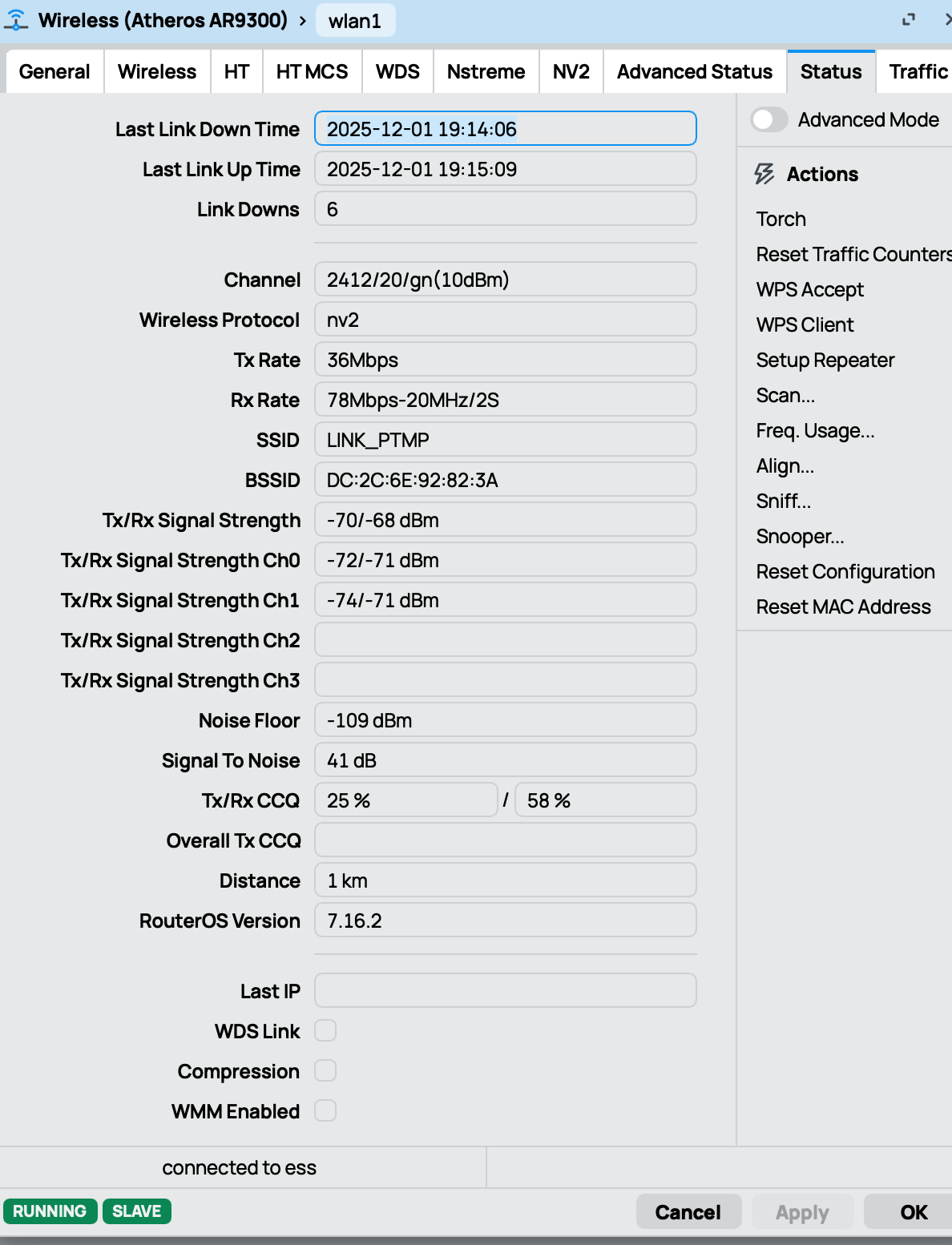

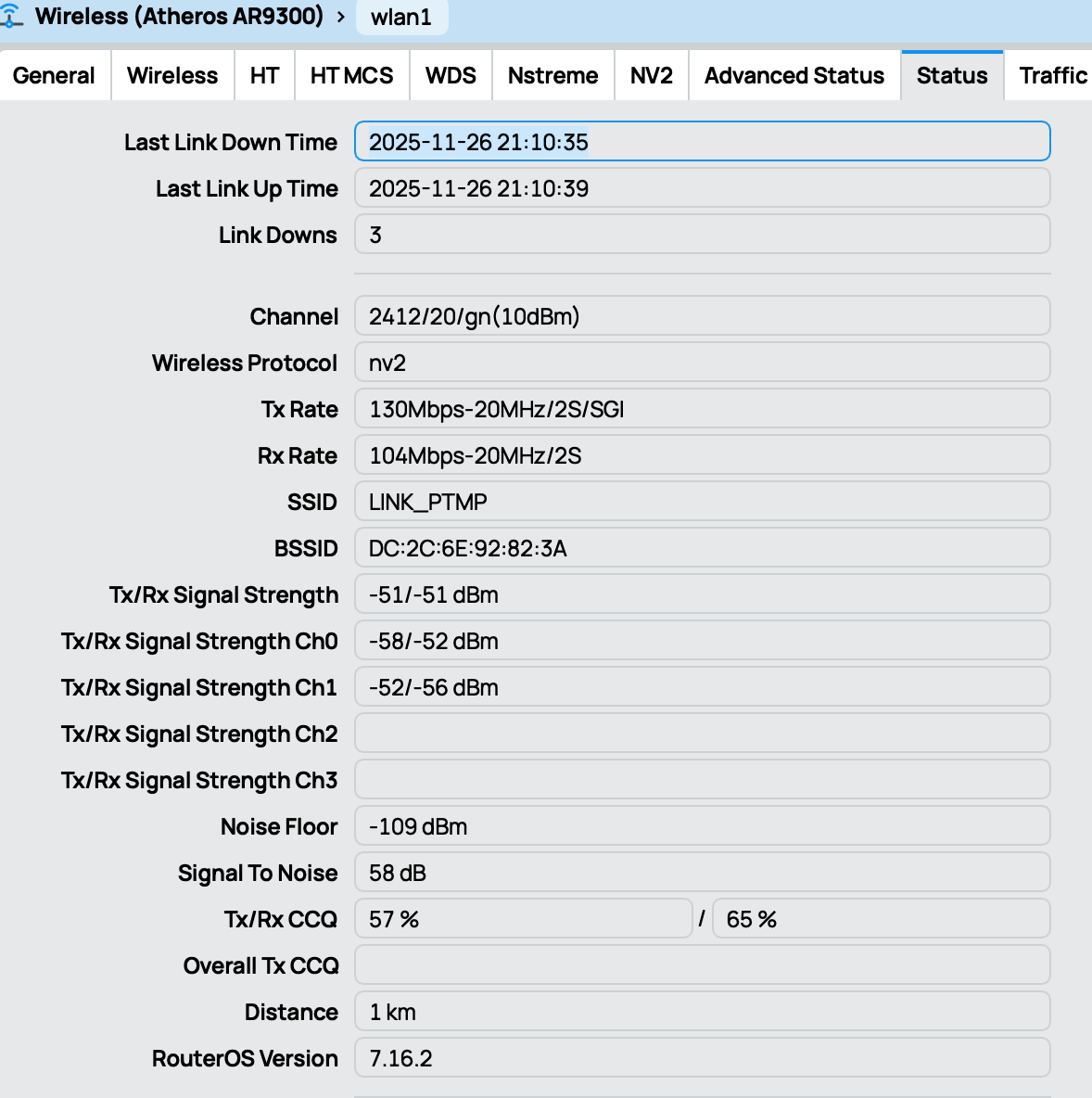

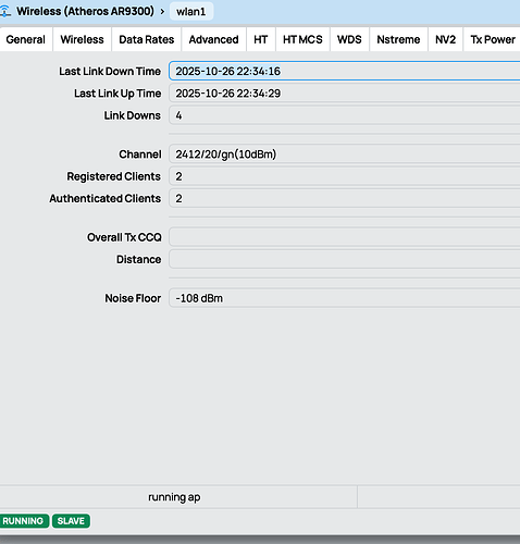

Check the CCQ on the third picture. It's 25%.
According to Wireless Troubleshooting - RouterOS - MikroTik Documentation it seems that the connection is not as good as you think.
What is CCQ and how are the values determined?
Client Connection Quality (CCQ) is a value in percent that shows how effective the bandwidth is used regarding the theoretically maximum available bandwidth. CCQ is weighted average of values Tmin/Treal, that get calculated for every transmitted frame, where Tmin is time it would take to transmit given frame at highest rate with no retries and Treal is time it took to transmit frame in real life (taking into account necessary retries it took to transmit frame and transmit rate).
Right at the beginning. :wink:
The 46 m can be bridged with anything.
The 450 m are not so easy.
Or, if you prefer, the 46 m link should be - with your used hardware - "rock solid", the 450 m link hardly so.
The SXT2 has a 60° beam width, so your two stations are well within its cone.
BUT the Sxtsq Lite 2 are also 60° (please read as "very wide" for a station).
If both links, the short and the long one, are unstable, the most likely reason is interferences, the 2.4 GHz is often very populated.
Since they have such a wide beam, it is improbable that antenna aligment would matter, while the placement (fastened to a wall vs. at the top of a wobbly pole) may make some difference.
More recent devices tend to be 5 GHz or 60 Ghz.
