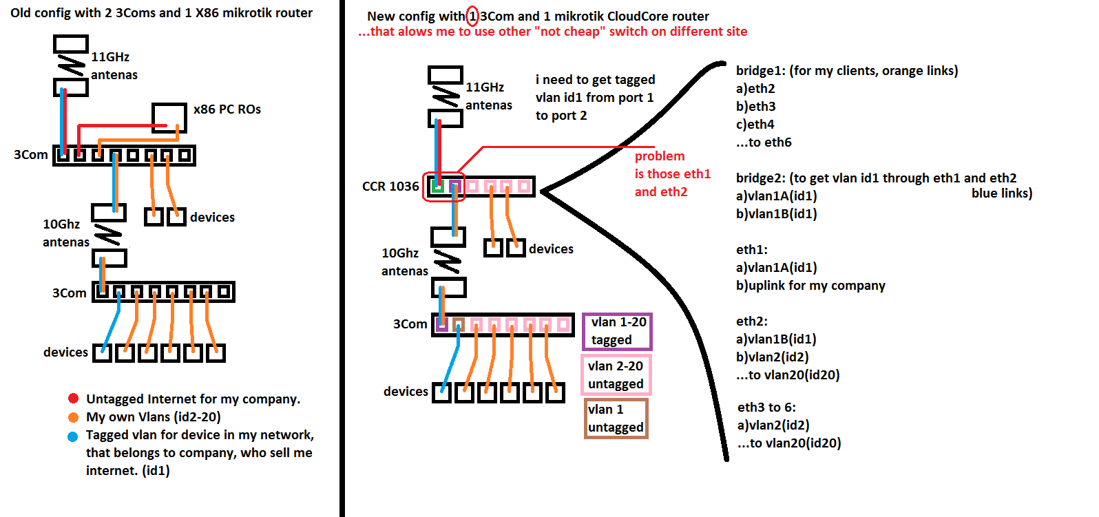

i bought CCR1036 as my main router and i need to get tagged VLAN through it…
here is what i have and what i want to have:
IMAGE HAS ERROR, NOW ITS OK:

i am sorry, i am not able to post it, because i needed to change x86 Atom with CCR very fast so for now CCR works the same way like Atom - only 2 ethernets online (WAN, LAN)
but is is the 12GE ports, i need to use 1/0/1 to uplink (tagged, id76) + vlan id185 directly to port 2, where is 10G antena to other place where is the device which need vlan id185 + my vlans
BUT! on port 2-12+4spf i need bridge (LAN - speed regulations)
so config was like this:
Bridges: 2
bridge1 has 2 items:
vlan185-1
Vlan185-2
bridge2 has X items:
port2
port3
port4
port5
port6
port7
sfp1
sfp2
sfp3
sfp4
ports:
port1:
vlan76(id76) - my uplink
vlan185-1(id185)
port2:
vlan185-2(id185)
vlan2970-2985 (my vlans)
(bridge2 was for 185s, and both was on the right ports, but in office i tried to use 2 tagged notebooks on vlan185 to port 1 and 2 and they could not work together, i just need some way to get 3Com from that site and let the 2nd company manage and ping their device on their vlan185
hope this helps…

it is, but with old config (left picture), that means i use only WAN and LAN and vlans managed by 3Com Switch, and i cant just play with it, cuz i have homes and offices and buildings connected to internet
i am only not able to get tagged vlan through it, just as layer3 comunication
i needed to instal CCR fast after buy cuz x86 was weak for my traffic, thats why i have to put it there with old config (2ethernets used)
