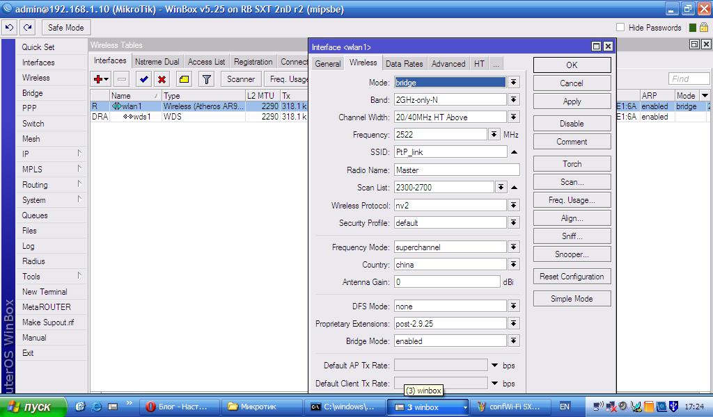

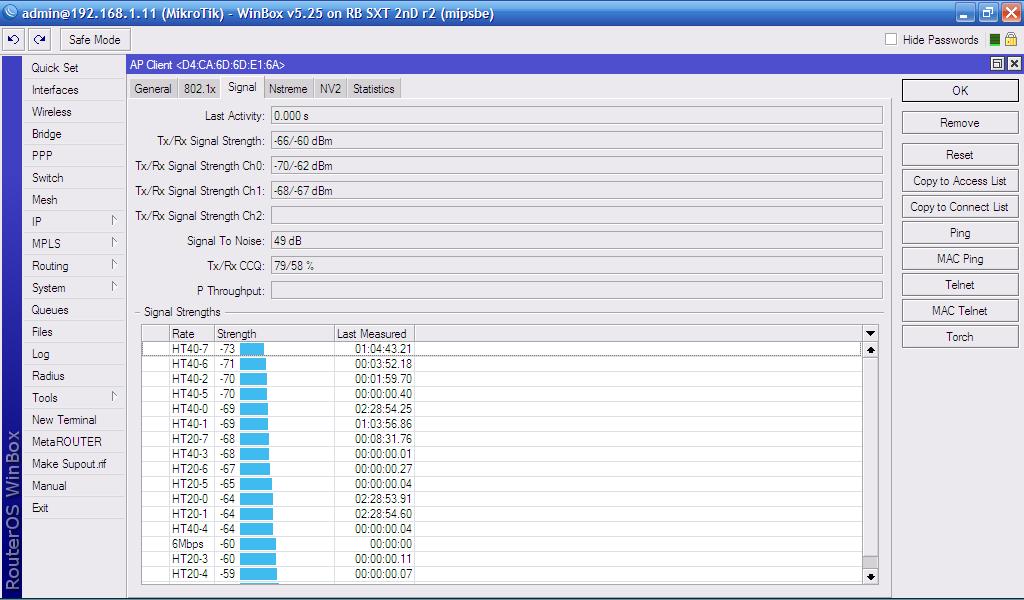

Configuration on SXT#1

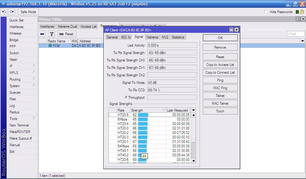

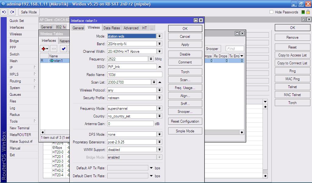

Configuration Wi-Fi on SXT#2
If you need transparent bridge use mpls/vpls and instead of wds, its much faster
Thank you i will try.
Firtsly, you NEED to allign your antennas better.
You need to config, bridge and station bridge mode faster then wds
