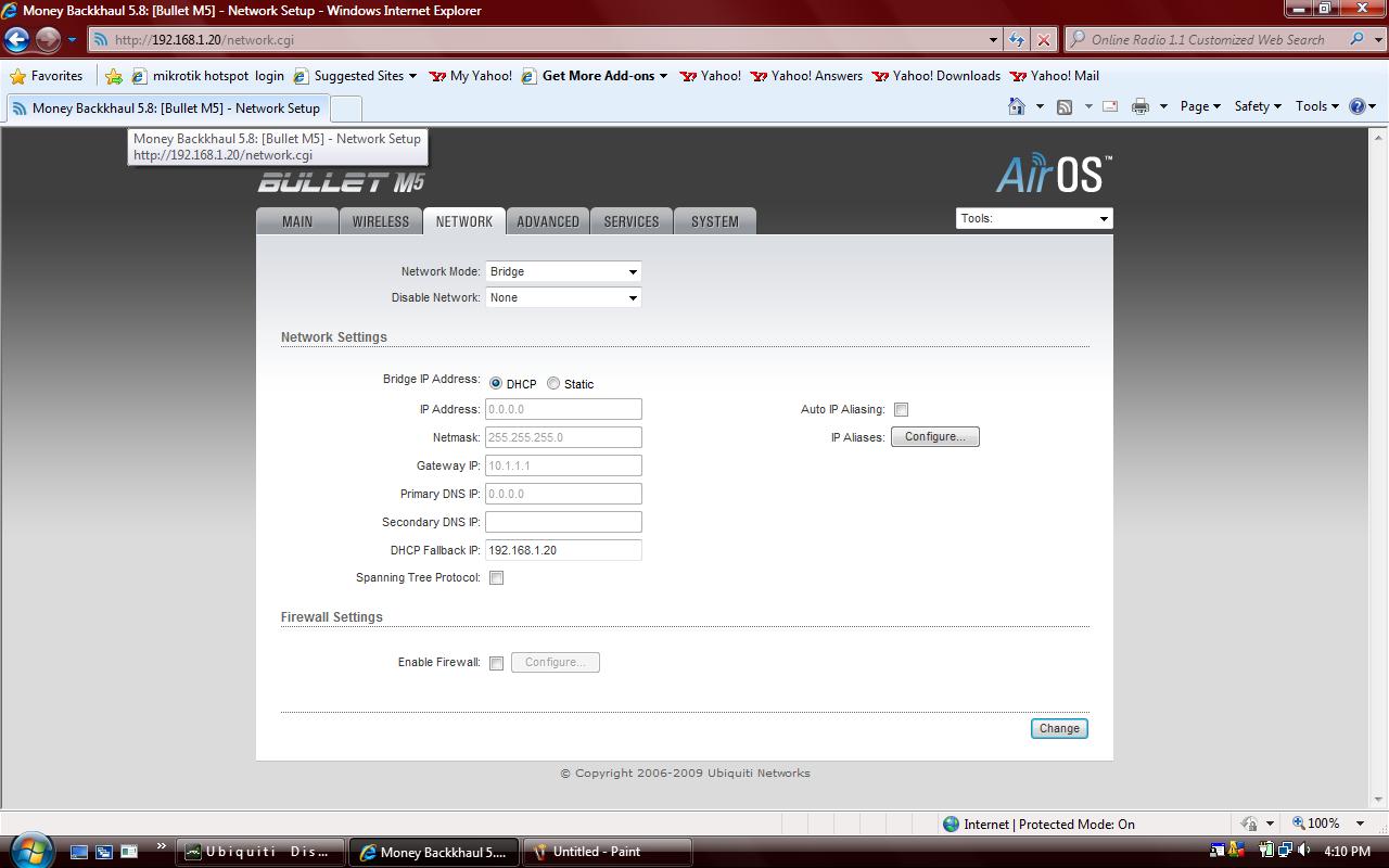

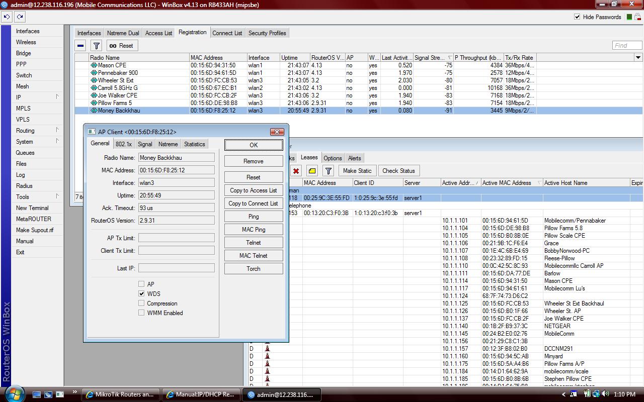

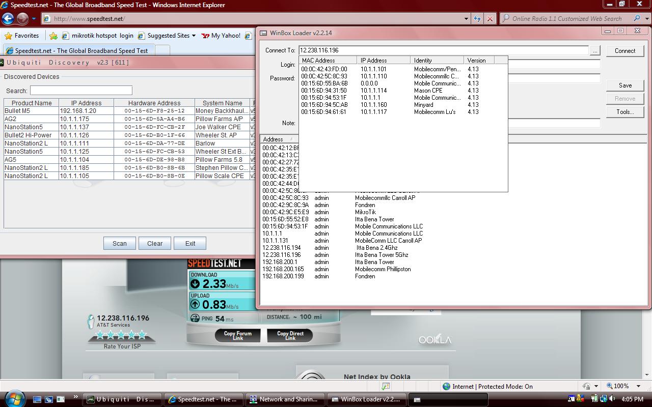

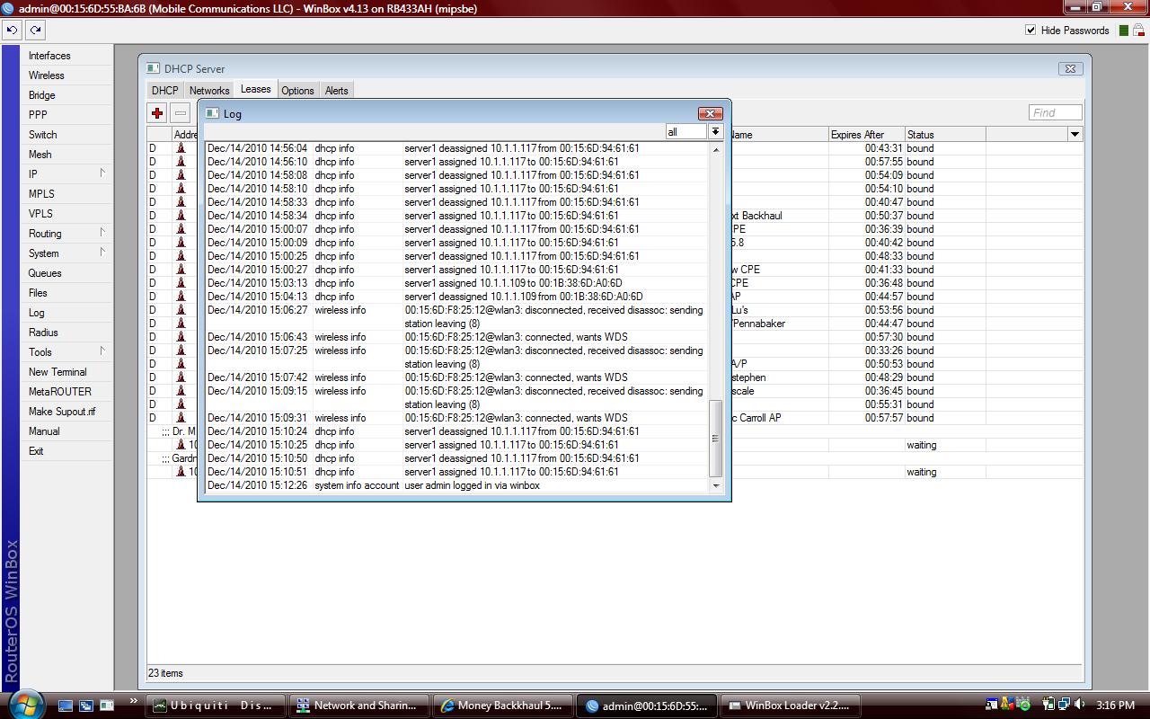

Mac 00:15:6D:F8:25:12 is the UBNT device, now it is connected and has internet as you will see in the next screenshots. How can this UBNT have a 192.168.1.20 default fallback address and still have internet. This is only one of the problems I am having and I think it is related to the issue I started this thread with. were are having some kinda DHCP issue, as if I reboot the Mikrotik it will allow the UBNT (not this one on screenshot) cpe to connect and pass internet. When we go out to customers location on a complaint that they get connected to the internet, we check cables, signal and everything we can. Signals are great, it will get a IP from mikrotik but it will just not pass the internet untill we reboot the main mikrotik.

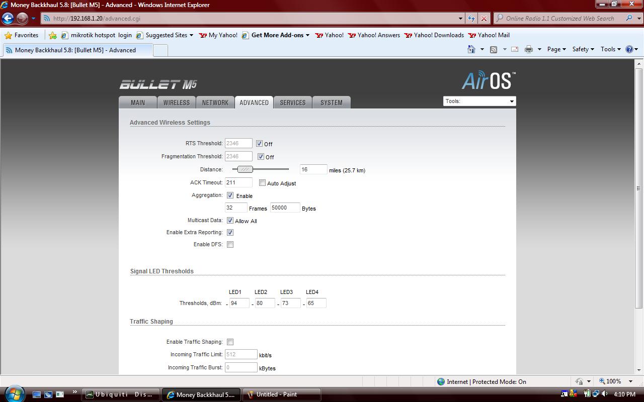

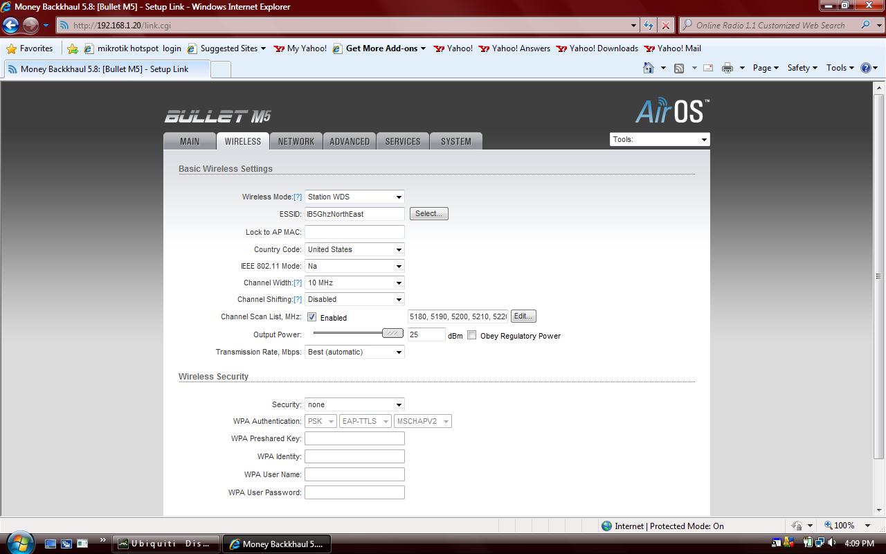

Now this above screen shot and the ones below are from a AP set up using (2) UBNT Bullets, the station side(backhaul) is a M5 and is set to station WDS and is locked on with a weak signal but it is doing close to 3 meg down with a 54 ping time as seen in screenshots. The other M2 is set up as AP WDS and this is were the problems started. I can lock on the AP but I cant get a IP from the DHCP and it will not pass internet. The M5 and M2 are connected with a jumper cable into the lans. I can take the jumper from the M5 and connect to my laptop and I can get a log in page and log into the server (12.238..) and get auth. to get on the internet. BUT I have a IP of the default 192.168.1.20 were the DHCP of the mikrotik should be handing out 10.1.1.***???

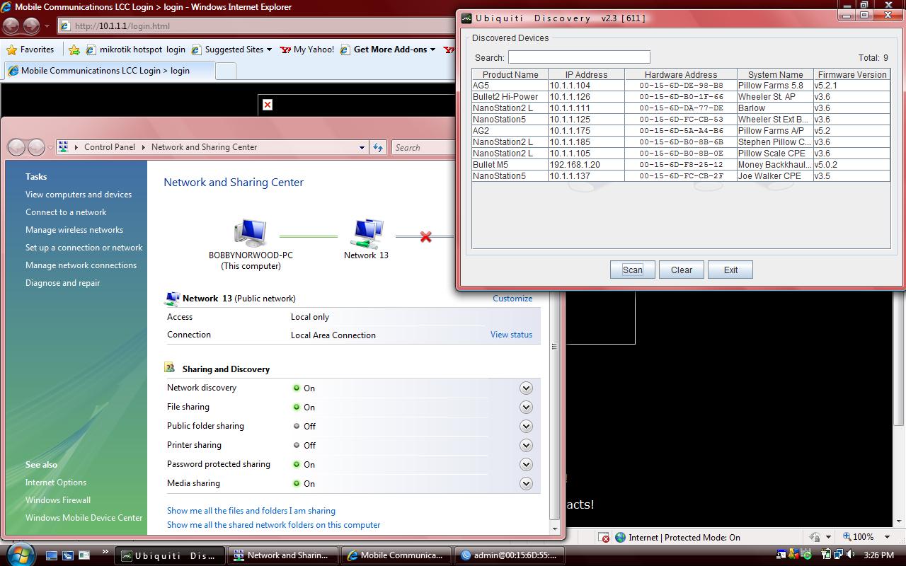

Also, notice in the winbox scan how I am seeing a mac address with a 0.0.0.0 address? That is the main mikrotik running the internet for this subnet. But I see another mac that is close to this one and it is named the same also???

Mac 00:15:6D:55:BA:6B with a IP of 0.0.0.0 has same name as Mac 00:15:6D:94:53:1F with a IP of 10.1.1.1 ???
What is up with this?? could this be what is causing the dropping of the internet

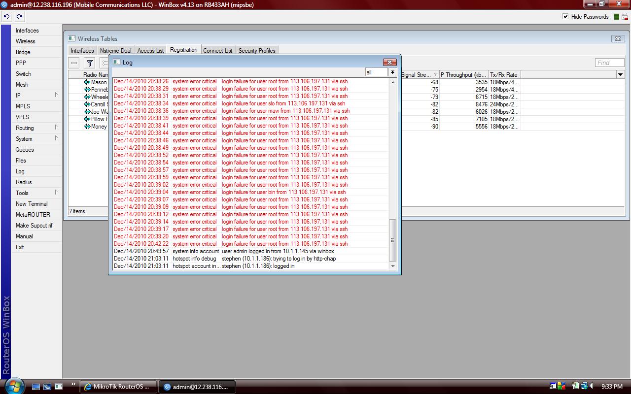

Here is the latest screenshot, Looks like someone is trying to hack into the mikrotik, bastards..
The most likely cause is simply a compromised machine brute forcing anything it finds with an open port for SSH. You should implement some firewall filter rules to only accept SSH access from admin networks.
It is very unlikely someone is actively targeting you, and very likely that the “attacker” is a victim himself.

If you only have one admin network you can edit “/ip services” and assign the network to the SSH item. If there’s more, make an address list and refer to it permitting traffic, then drop the rest. Where it goes in your ruleset is impossible to answer without knowing what your ruleset is. Put it where it makes sense, I guess.
/ip firewall address-list
add list=admin address=1.1.1.1/24
add list=admin address=2.2.2.2/24
add chain=input protocol=tcp src-address-list=admin dst-port=22 action=accept
add chain=input protocol=tcp dst-port=22 action=drop

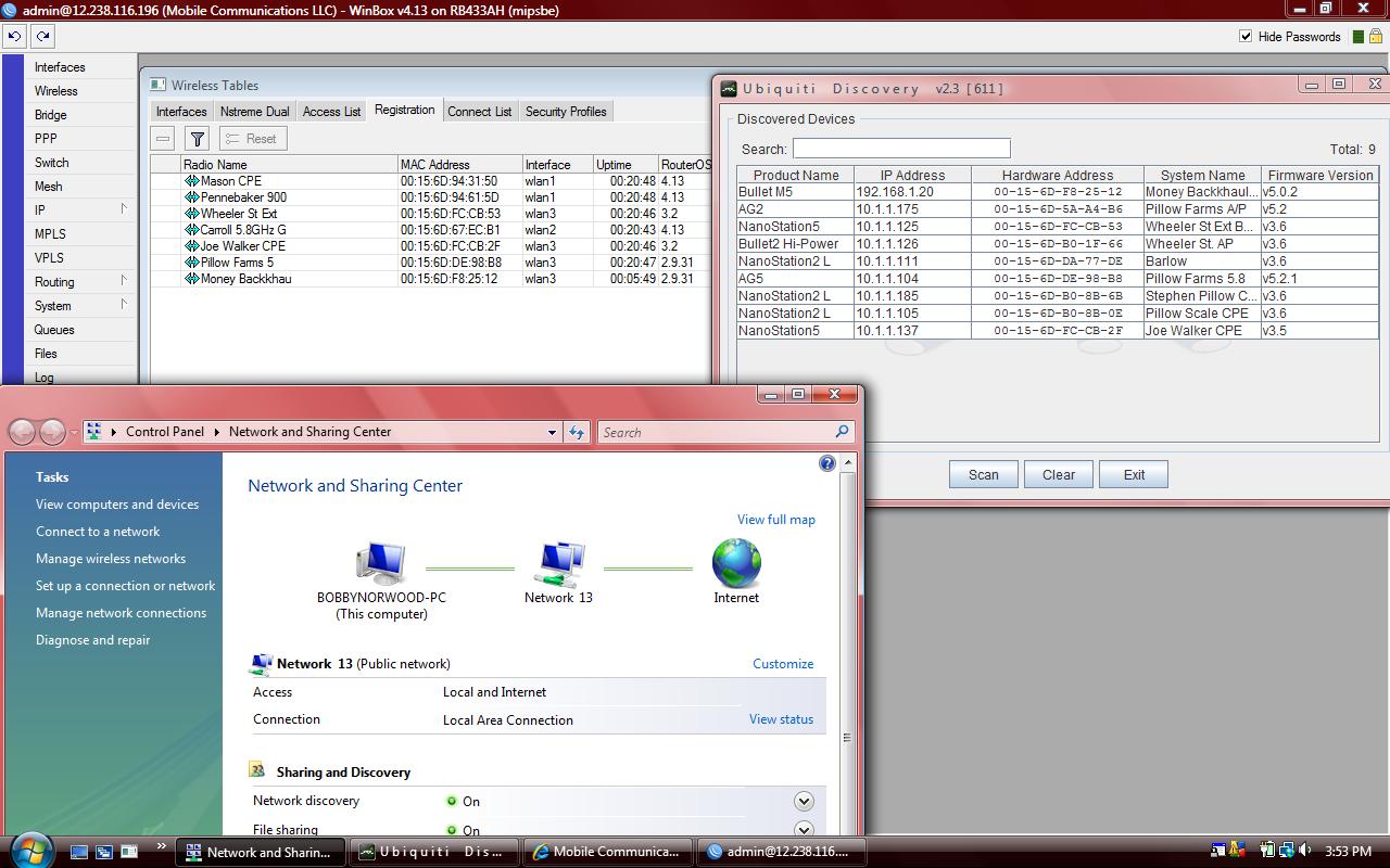

Why is it that my Money Backhaul Bullet set as station WDS cant get a IP address from the mikrotik? Here is screenshot of this, I know the signal is bad, but I can do a speedtest and get 51 pings with 2.9 meg up and down on a 3.0 meg line.
I have included the screenshots otf the setup in previous post. Any help in the direction of things to check would be greatly appreciated.
