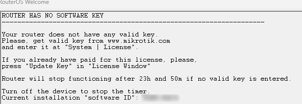

help!!! received a warning that the authorization is invalid
Today my CCR1016-12G received a warning that the authorization is invalid. Follow the prompts to update the License key, and it shows “done”, but after logging in again, the same prompt remains, indicating that the router will stop operating within 24 hours. What should I do?
I also submitted a support request, but never got a response. I have used several mikcrotik hardware routers, this is the first time I have encountered this kind of problem, please help me.

device serial number and supout.rif file has been sent to support@mikrotik.com,hope it can be resolved soon。
no response received
The business cannot be stopped, and there is no choice but to replace the backup route.
When I replaced this router with a spare router (also a ccr1016-12G), the replaced ccr1016 with a problematic authorization went back to normal after re-powering on and logging in, and there was no authorization prompt. Not sure what the problem is. Luckily I have a spare router, otherwise it would be really troublesome.
