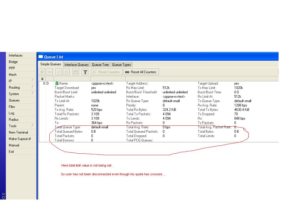

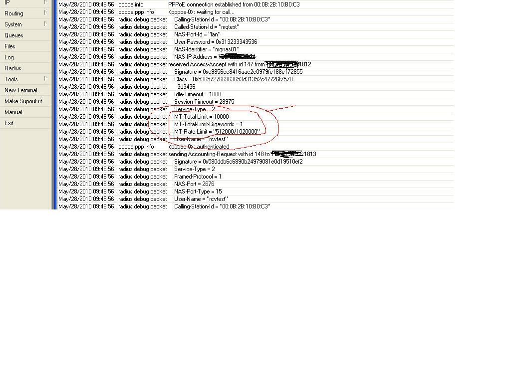

Here something we observed : Radius sent “Mikrotik-Total-Limit=10000” attribute as part of Access-accept to mikrotik but we are not able to see the same in QueueList for that subscriber.
(im sending two snapshots regarding above problem , please find the attatchements )
Could someone please help me out.
for the ‘Total’ to be counted, you should change something in that queue: either set ‘Total Max Limit’, or change queue type to something else (like ‘default’ instead of ‘default-small’)… just not sure how that can be done with dynamic queues…

for recv and xmit you set rate limitation: 512k/1020k. that’s why those queues are actually installed and count traffic. your ‘total’ queue has no rate limitation, and is not installed for optimization. that’s why ‘total’ queue is not working as you expect

One configuration item in /queue simle’ can create from 0 to 3 separate queues - one queue in global-in, one queue in global-out and one queue in global-total. If all properties of a queue have default values (no set limits, queue type is default), and queue has no children, then it is not actually created. This way, for exanple, creation of global-total queues can be avoided if only upload/download limitation is used.
your ‘total’ queue is not created, that’s why it doesn’t show any stats

Radius is sending following attribute to mikrotik as a part of Access-Accept . but user is not being disconnected after his Quota ( which is 10000 ) exhausted.
