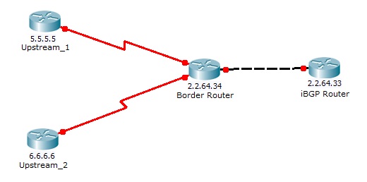

I have 2 upstream. My BGP runes fine. But I can’t control the upload. In my configuration, I can only handle upload to any one upstream by changing the value of “bgp-local-pref”
add chain=UPSTREAM_1_IN prefix=0.0.0.0/0 action=accept bgp-local-pref=150
add chain=UPSTREAM_2_IN prefix=0.0.0.0/0 action=accept bgp-local-pref=300
But I want to control it. Like:
  1. upload traffic will same as download traffic (same network’s upload and download will go thru same upstream)
  2. control specific (/24) network’s upload to specific upstream as I want.
My configuration is given below. Please help me.

Why don’t you accept more routes than just a default from your providers? If both providers gave you a full or partial routing tables then BGP route selection would hopefully result in you splitting your upload between the two providers, with automatic failover in the event of a failure of one of the links.
Thanks. But i didn’t get you as I know BGP very little :frowning:
Please explain with code.
Instead of:
add chain=UPSTREAM_1_IN action=discard
add chain=UPSTREAM_2_IN action=discard
Why don’t you have something like:
add chain=UPSTREAM_1_IN prefix=1.1.0.0/20 prefix-length=20-32 action=discard
add chain=UPSTREAM_1_IN prefix=2.2.64.0/21 prefix-length=21-32 action=discard
add chain=UPSTREAM_1_IN action=accept
add chain=UPSTREAM_2_IN prefix=1.1.0.0/20 prefix-length=20-32 action=discard
add chain=UPSTREAM_2_IN prefix=2.2.64.0/21 prefix-length=21-32 action=discard
add chain=UPSTREAM_2_IN action=accept
Why are you discarding routes from your providers except the default route? If you get more routes from your providers then your routers will use this information to decide which provider to send the traffic to.
this is working as like as my code. the upload is going over one upstream.
How many routes are your learning (via BGP) from each upstream? Are they sending you anything more that just a default route?
nope. they just sending me default routs.
Perhaps ask them if they can send you Partial Routes so your router can use the additional information to make its routing decisions?
