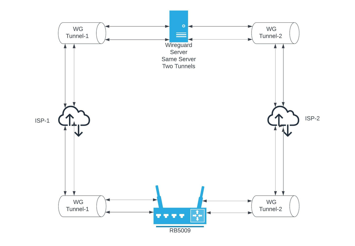

I tried my best in this diagram to explain what I want to do. Hope you get it this time.
Basically, I want to route WG Tunnel-1 via ISP-1 and WG Tunnel-2 via ISP-2. Both of the tunnels are from same server.

Excellent diagram now fill in the holes.

I would like to answer Q7 so most of the first ones will be easier to understand.
Answers ~
Q7. This is a local IX connected third party server. Both of my ISPs are connected to the same IX as the server, so whenever I am connected to the Wireguard Server, I get a speed boost. Now I want to keep two wireguard tunnels connected to the same server but using both ISPs.
Q1+Q2+Q3+Q4. Some selected address where I want my boosted speed to work. i will merge both tunnels using load-balancing for those destinations only. For ex., Google Drive Downloads, Some other download sites etc.
Q5+Q6. I would say no. These tunnels, I may use them for all the users on my network and for selected addresses only. So whenever they are hitting those heavy downloading destinations, they will use local IX bandwidth and get extra speed boost.
Q8a+Q8b. Same Endpoint address and Port.
Q8c. I got two wireguard.conf from the server. And, set them up as two differnet wireguard interfaces.
