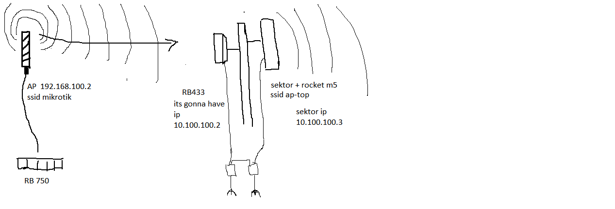

Hello everyone.If you see the picture (sorry im not a good painter ) i want to send signal from ap bullet with ip
192.168.100.2 and ssid “mikrotik” (to this ap ive connected other clients ) .i want to send it to rb433 with ip
10.100.100.2 mikrotik is connected directly (lan adapters ) to sector m5…My only problem is to configure mikrotik
to recieve and to send packets to sector m5…
so in bridge menu add a bridge1, add on port the interface eth1 and wlan1, here your have the bridge. Now on wireless menu put the mode on station-wds and put the ssid of your bullet, in wds menu choice dynamic and prefered bridge choice bridge1 and ejoy.
