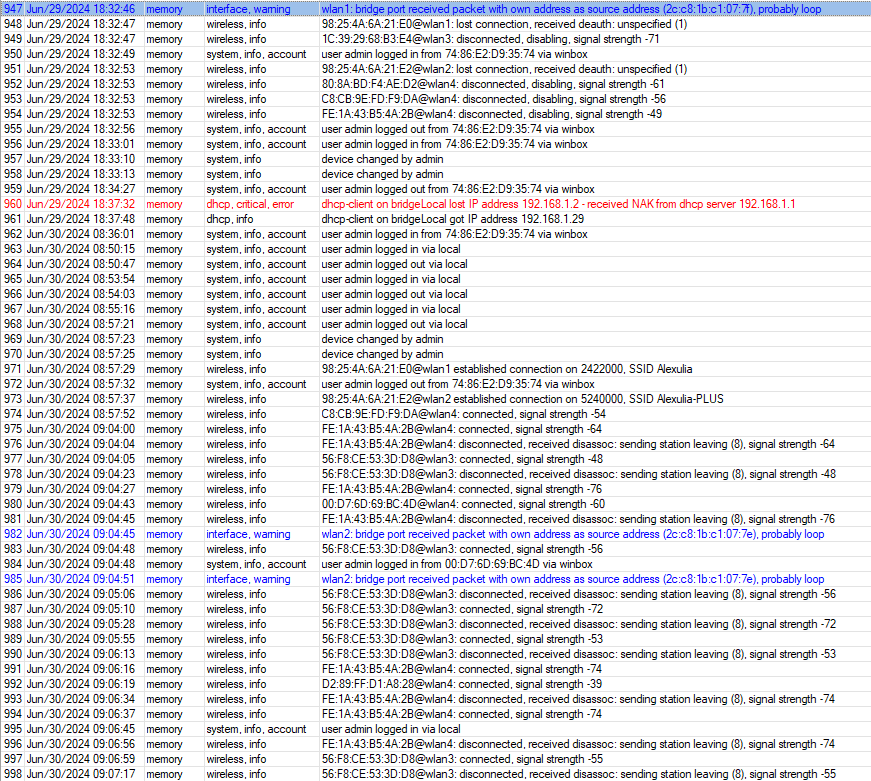

It worked as mesh, but I was getting a lot of issues: either connection failures or being unable to get an IP address from the modem/router. The connection was completely unstable and I had to deactivate my MT wlan interfaces.
I’ve attached an image with the last logs. That may help you help me :smiley:
Any ideas?

Yes, it was really bad. When you create Mesh you can use 2 ways: WDS or MESH.
In either case, the 5ghz radios are in AP mode.
WDS mode: inside the radio choose advanced mode, ADVANCED tab, change Distance:INDOORS. Then go to WDS tab and WDS Mode: dinamic mesh, WDS Default Bridge: YOURBRIDGE.
The SSID and Password must be the same as AP1.
Regarding this, this works fine if there is no ethernet cable link between the two Mikrotik APs. Because otherwise you would have two links between them. MESH mode works the same way.
If you have wired APs, only use the same SSIDs and limit access by ACCESS LIST.
Mikrotik has very good results with WDS, even better than mesh. In our infrastructure we use Hap AC Lite in urban buses, with WDS in 5ghz, at each end of the buses there is an advertising Android TV, and the link works to update the content between the same buses, without them reaching their base, which they do touring the city. This has been working for more than 5 years.
You can even connect to a mikrotik from an android to its wds ssid (Distance Indoors helps). But…there is always a but, it is not usually compatible with other OS. I never managed to really make mikrotik meshes compatible with TP Link or Openwrt. Maybe someone has done it. I prefer to keep the ETHER binding
I will give you the example of the Wifi infrastructure in our offices, where there are TP Link, Mikrotik, Openwrt, Xiaomi, etc.
Mikrotiks work as routers/firewall/vpnss, etc. The rest, without distinction of brand, function as extenders, fully bridged, and all with the same SSID signal, at different frequencies. They should not overlap. Those who are NOT mikrotik, the power is limited, everyone has that option. and the Mikrotik have access rules for dbi signal, if it does not cover the signal expectations, it is disconnected.
But keep something in mind, if you have cable, you don’t make a mesh. You only do it if all the APs are Mikrotik, and through the “MESH” menu, which is like the traditional BRIDGE, but only works with mikrotiks, you put everything there, including the ethers, sfp, wifi, etc.

If you try to connect as a Station (client) to the tplink, and then create another AP, you have 2 problems:
  • You create 2 links to TPLink (you already have the wiring)
  • You kill the radio. You are reducing its power.
So…in other words, I can’t create a mesh network like I tried?
You can create it. But you must disconnect the ether cable. and it really doesn’t make sense. Wireless meshes work on routers that are not connected by cable
What about going back to my first reply?
If your Cap AC and TP Link router are connected with an ethernet cable, you do not need to try and connect to your TP Link router with a WiFi connection. The connection is made via the ethernet cable, this is the best way to do this for the backhaul to your router.
If you haven’t already, upgrade your wireless drivers to the Wifi-qcom-ac ones, they a lot better. Plenty of posts as to how to do this, basically you remove the wireless driver and upload the Wifi-qcom-ac drivers. Then set you Cap AC up as an access point only, no DHCP, no NAT, no firewall. If you can’t do this through quickset, completely wipe the config with winbox, then add a bridge, add an IP address to the bridge you created on your networks subnet, add all ports to this bridge. Add a default route back to your TP Link routers IP address and add DNS to point to your TP Link routers IP address to make updating your cap AC easy in the future.
With the WiFi / wireless setup do not use quickset as it will wipe your config you just created. You need to set exactly the same SSID, Password and security as your TP Link router. Everything should then just work, the client devices should then roam by themselves between your access points.
In the cap ac you only have to make a bridge with all the ports, and create the wifi signals
