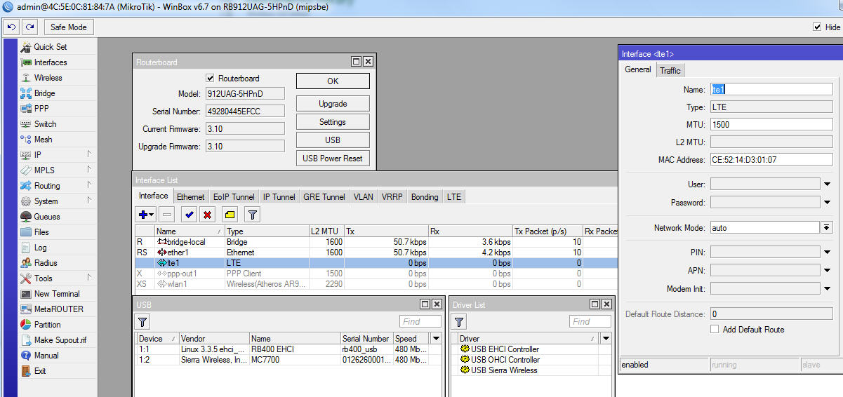

Looking for some help getting started, I have a Sierra MC7700 mPCIe LTE card installed in a RB912UAG-5HPnD. Just want to use this as an Internet connection in a remote location, don’t need the wlan, just need to have access through the Ethernet port.. Got the mPCIe port enabled and it seems to have loaded up the Sierra driver and created the lte1 interface OK…
This is where I’m at, can someone help me with the next step?

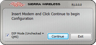

My device came set in “QMI” mode, I had to switch it to “DIP” (DirectIP) mode for it to work using the Sierra DIP-QMI Switcher tool:
