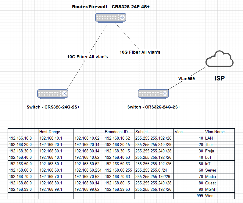

I have these 3 switches 1 CRS-328-24P-4S+ and 2 CRS-326-24G-2S+ from mikrotik which I have put some vlan up on.
they are connected to 10G fiber modules.
after my setup I can only measure approx. 200mb over my cables :frowning:
i’m pretty new here in the mikrotik world and am convinced it’s is something to do with my setup.
Hope there is someone who will look a little at my setup and tell me what I am doing wrong so I can make everything work right.
