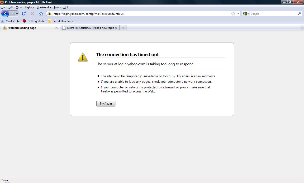

hello,
I am having some problems with opening mail.yahoo.com, for some people on my hotspot. They cannot open yahoomail site but other sites can open.
What shd be the likely cause of this problem.

Try to set MTU to 1480 or less…
My router board is in bridge mode, but the hotspot server is on a pc running ver 3.22.
Where and how in Mt do i set the MTU.
flav what is the deference if i modify the MTU? my MTU set as default but other guru change their MTU
