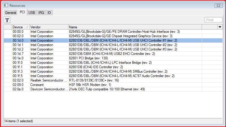

Since I am using an eMachine PC with RouterOS 4.16, how do I check to see if RouterOS recognizes the USB ports on the Motherboard. Is there a way to see what hardware is supported and functions and what is not?

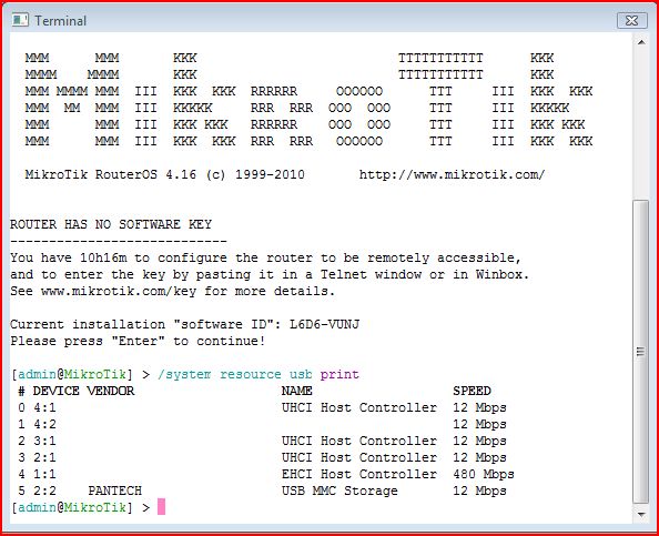

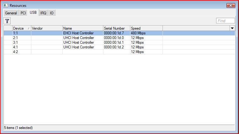

From the WinBox>System>Resources I can see the USB controller.
Here is where I am at now.
I can see the Pantech device connected to USB 4:1
it is listed as an MMC Storage device. I am not understanding how to create an interface that ties to the USB device (only Serial0 showing as a port). Only showing the NIC cards as interfaces… I must be missing something really simple. Down to 10 hours on this trial… any help would be grand.

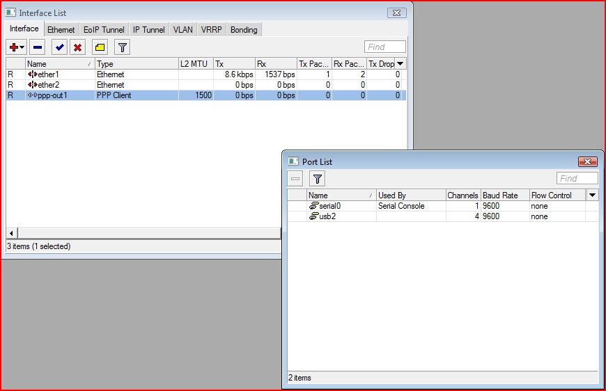

Okay so I am one step closer…
I took an old Sprint USB 3g modem (Novatel Ovation U727) and plugged it into the PC.
I now have a USB2 Port and a PPP client interface.
So what am I missing to make the Pantech (UTStarcom) UM185 do the same thing?
