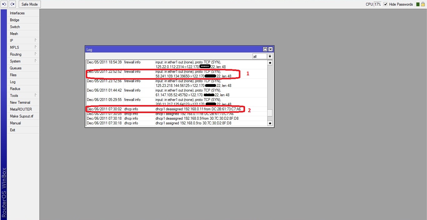

Today when I saw log of mikrotik then I found that there was some activity from firewall at night timing which actually worried me because we don’t work at night.
So please help me understand the log what exactly is the meaning for no.1 and no.2 as shown in attached pic.

  1. a TCP SYN packet, initiating a TCP connection to port 22 (SSH) of your router. Someone (maybe a bot) was trying to SSH on the MikroTik
  2. Every DHCP lease has its time. It is specified in “lease-time” parameter of the server. Usually - 3 days. If a DHCP client doesn’t refresh the lease for the time - the lease is deassigned. That happened in the logs :slight_smile:.

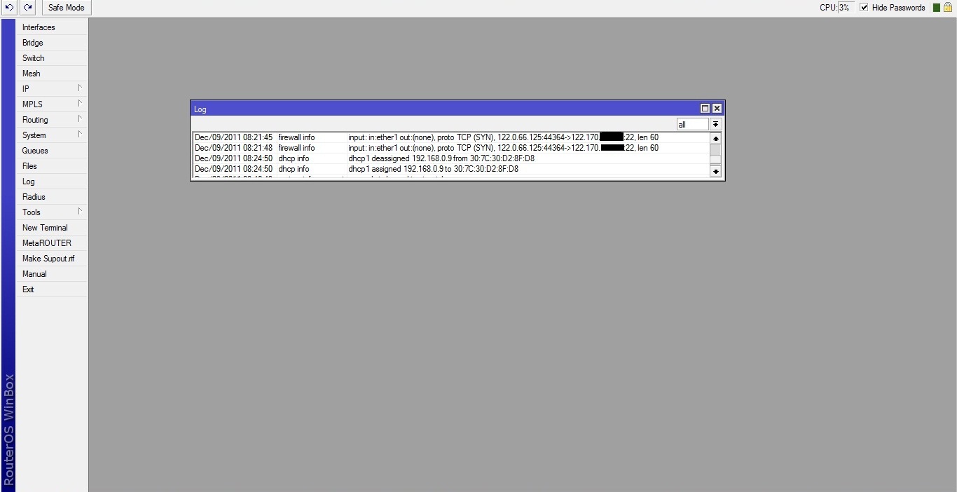

I have disabled my ssh on mikrotik but still I can that firewall info is showing that someone is trying to login.
Now what should I do?
Screen shot is attached.
Thanks in advance.

Nothing. What else is there to do? There’s nothing listening on the port anymore, and you can’t stop the packet from arriving on your router port (unless you control the other end of the connection as well).
Someone is trying a key on the door to your house. You changed the door so there’s no longer a lock at all, but he keeps trying a key. Unless you control the street and can keep him from touching the door at all there’s not much else you can do, but there is also little point in worrying about someone using a key if there’s no actual lock to put the key in.
