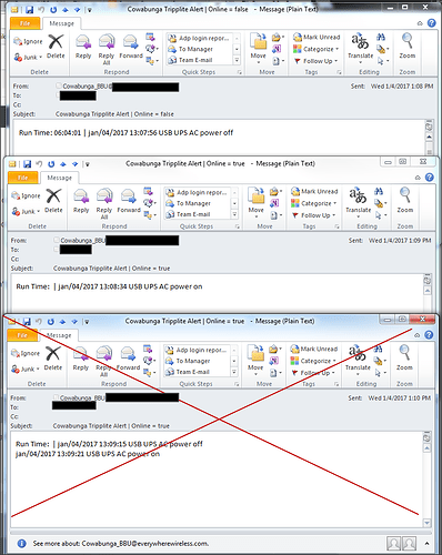

Help: UPS Script Email based off log events.
I'm trying to figure out if there is a way to update this script to ignore any events that are within 1 minute of each other.
I have a scheduler running every minute. I'm getting the desired affect but, i'm trying to get rid of false positive alerts.
