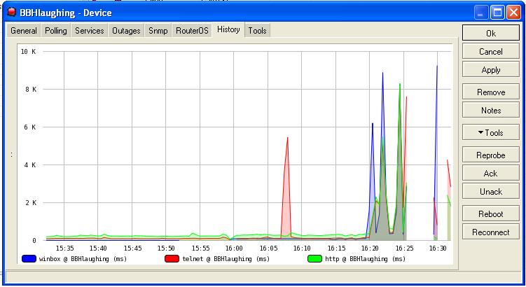

I till can double clink the drive and use tool winbox to go to the routerboard although the drive show is red and in service window show the winbox is timeout and Http time out and telnet timeout. they are all OK but only in Dude show they are red and Failed to connected

and from history i can see some time is working some time not

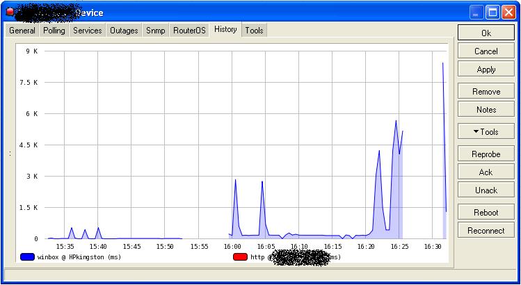

So if you add the ping service to be monitored for that device, does it timeout as well ?
Perhaps you may just have a busy link to the device which is causing everything to timeout.
This often causes the gaps in the graphs like you have, and if that is the response time for winbox checks then I would say it’s your problem. If this is the case, you will need to fix your link to get rid of the latency or increase the timeout values of your services so that you can actually get a result back in an amount of time that works.

That is really helpful.i think so they have a busy traffic every time they link make rx693dps.
