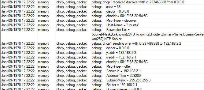

I don’t know why I didn’t think of this before but I started checking the DHCP log RB750 and I saw this…
Similarly if I add vlan100 on RB951 as a DHCP client I get the same messages on the RB750.
So it seems the DHCP message isn’t getting back to the RB951, so I’m guessing a routing issue…I’ll keep tinkering, but if you can spot the problem let me know.
Regards,
zb
