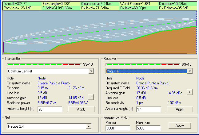

I’m getting ready to setup a 10.5KM PTP link using RB411 board w/ XR5 and 27dbi L-Com Grid antenna at both ends. According to Radio Mobile profile it seems is a clear shot. But, I have to cross a town that has a lot of interference and I’m not sure if these equipments are enough. I’ve read others have created longer ptp links but, don’t know the scenarios.

Today, I put up the two ends and I’m not able to see neither one when I do a scan. I really don’t know if there is LOS because like I mentioned in my ealier post: Radio Mobile shows a clean shot but, there are too many tall trees that might be interfering. Radio Mobile only shows terrain and not trees, buildings, etc… So is difficult to know if there is a “REAL LOS”. I’ll probably be needing bigger antennas. I’ll try to do some changes tomorrow.
do you really have a tower 100ft up and 56ft up? That link looks totally doable. Your RadioMobile shows .15w which is only 150mw. The xr5 should be .6w. Dont change the power settings in RouterOS for the XR5, it already knows the offset and thats why it shows real vs total. That link should be no problem unless there truly are trees 50-80ft tall in the way.
I do have two towers, one is actually 120’ tall on two stories and the other end is 60’ on one story. The power on both XR5 are set to default, havent’ touch it. There are tall trees all around the area but, it looks doitable. Is there an utility or software I can use to see if there are any obstruction in the way?

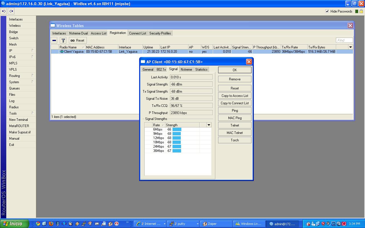

I just wanted to let you know that I was able to do this ptp link. I noticed the alignment was off on both sides (don’t know how it happened) so, after readjusting it the link was perfect. I was surprised it worked. First time I’ve done such long ptp link, longest for me yet.
