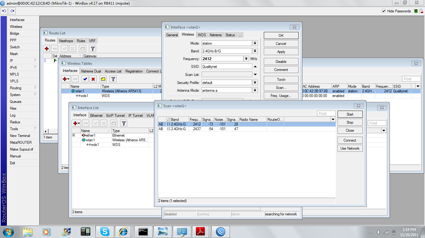

thanks for the reply, when i try to connect to AP, it says “searching for network” / disabled!. it seems like i can connect to the wireless AP with my laptop and phone, but i cant connect with Routeros

thanks, even when am not in scan mode, it stills says searching for network!
So, did you fill the SSID field manually ? If yes it always try to search for that and if your purpose is not to connect to that SSID, just remove it.
Try to reset configuration for the wlan1 and start again
i tried resetting the wireless interface to default, but it keeps searching for network, i removed the SSID but anytie i try to connect to a wireless network auto fill the SSID!

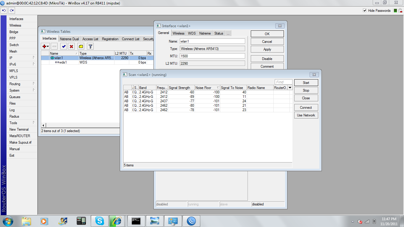

Hmm, what about signal strength?
Here
wow, what is that WDS? does your Provider in WDS mode?
