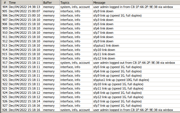

  1. All of a sudden all ports are in Bridge Goes down and after that immediately up, What was the issue, help me with that?
  2. if loop comes from sfp9 then sfpplus1 (main input sfp) also go down, what i want is if loop comes form sfp9 then only sfp9 down and loop block.
What did the admin user logged into WinBox do?
Guess, they were in safe mode, made some mistake, disconnected, and the previous config was restored that brought the links back up.
But that’s only a guess, given the details provided.
no safe mode enable!!!
Post full switch config. Without it we can only guess why loop in sfp9 disable also sfp-sfpplus1. You also need to tell which other port is involved in loop (apart from sfp9). If it’s sfp-sfpplus1, then swithc should disable one of involved ports … which one is it depends on setting of _path-cost_setting for each individual port (in theory the one with higher path cost will be disabled as long as the other one is alive).
Also tell us which switch in particular you’re talking about. There are a few models that experience port flaps occasionally … making flap all ports handled by same switch chip. If this is not due to some misconfiguration (we’ll try to see if/when you post the config), then it’s something to be reported to Mikrotik support … along with supout.rif file created right after flap occurs.

I’m not intimately familiar with CCR1xxx … so I don’t see anything very wrong with your setup. What does pop from my memory is people having similar problems with flapping ports which ceased when LCD was disabled. You may want to check if that helps in your case as well. BTW, which ROS version is it?
any one !!!
I’m assuming you already followed my hint about LCD … but found out it doesn’t help?
