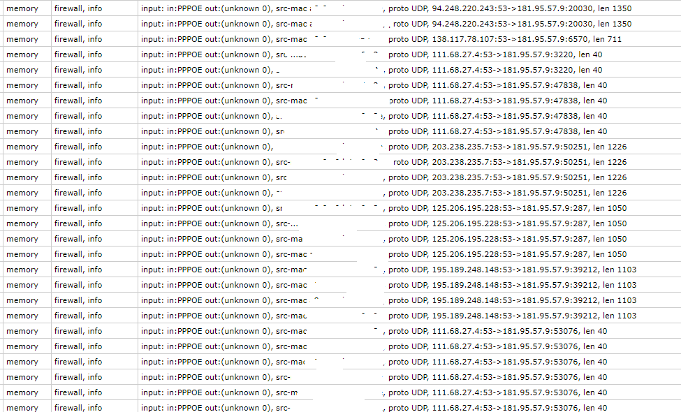

Hello, I need help, I have a Mikrotik Rb750gr3 Hex 4 Cores 880mhz Cpu Level and I am having ddos attacks on my minecraft port 25565, they have set me rules certified people of this device and it does not block the attacks .. ideas thank you I send you an example of how they are Although the attacks vary, some saturate the broadband. If you have any skript or rules for this type of case I would appreciate it, thank you very much
one of the pages that attackers use is the following which would be the appropriate rule to stop such attacks [spam_link_removed] .. thank you very much for your help
Looks like a dons amplification attack,

This type of volumetric attack (dns reflection?) => you cannot “stop” it yourself. You need “upstream” support for this (= ISP)
Small UDP-packets are hitting your router and consume some bandwidth & resources.
