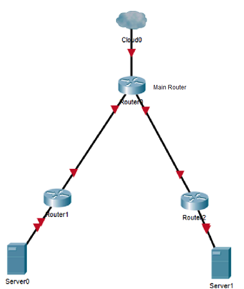

Maybe it’s an easy solution to my problem and maybe one of you has the solution. The problem is as follows, I currently have three routers connected to each other, two are RB4011 and the third is a CHR. The two RB4011 routers do not have public ip since they are with double NAT, so I have made a VPN connection using wireguard, and within wireguard I have an EOIP connection. With the configuration I have, I have a connection between the three routers and can reach internally from one server to another. The problem I have is when I try to access any of the servers using the public IP of the CHR router (Main router), I have created a rule in the firewall (dst-nat) but when I check if the Port is open from the outside, it appears as closed. From any of the routers I can ping or access any of the servers from any computer internally without problem. Maybe it’s some additional rule I have to add. Thank you for any help.
An idea of what I have.
