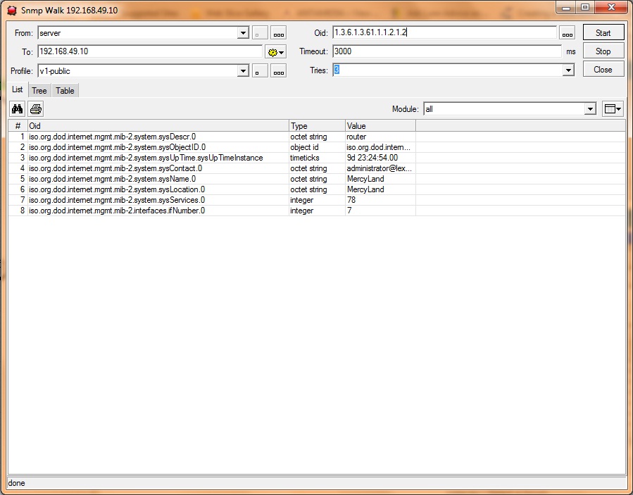

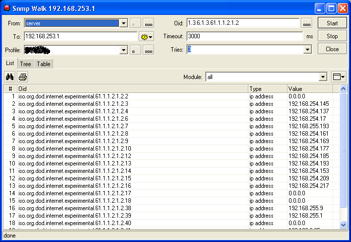

I am surprised that 1.3.6.1.2.1.85.1.2.1.4.224.0.1.39 is not supported but it is dod.internet.mgmt. If I am reading that correctly dod is department of defense?? If you don’t see the text for the OID you are browsing you can add the MIB to the files folder but I would only do this if you really need the text, why increase the footprint of the dude. I have included screen shots of some snmpwalks…
Oh doh all them start dod.something ![]()
if you look into the functions you will see … if and else if like the cpu usage function and some other ones. I attached shots of an snmpwalk with the oid you used . its so different lol.
