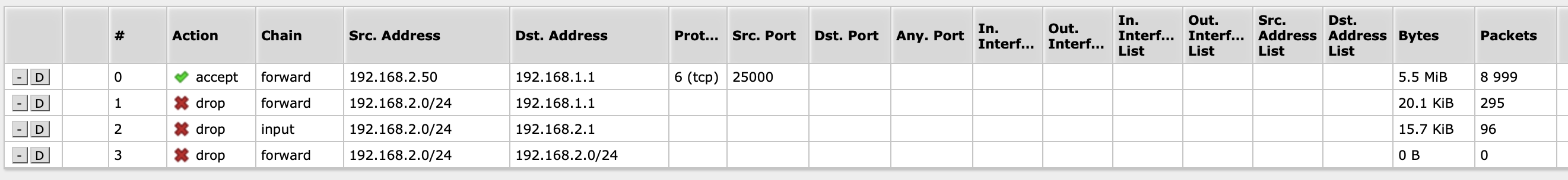

I have attached the screenshots of my firewall setup.
Everything seems to be working, however I am not sure if it is safe enough from potential hackers.

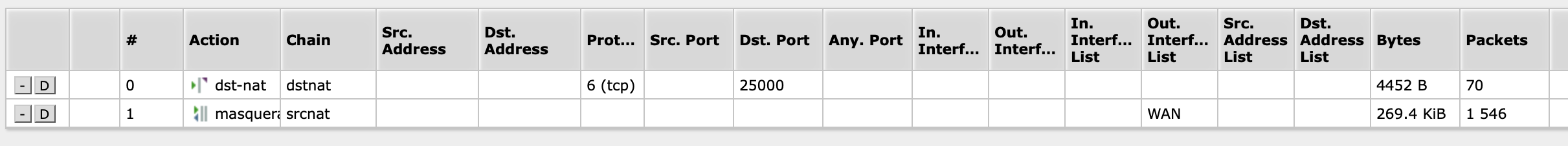

I might think about adding VLANs, however I thought that adding the blocking rule from 192.168.2.0 to 192.168.2.0 would stop VMs from reaching each others.
I have installed ROS on a VM in order to test it before buying an actual router.
The two screenshots are from the firewall filter and the nat one.
Thank you!
Ofcorse not…
Firewall Works on Layer 3 and effectively Layer 4 …
In order to handle Layer 2 traffic you should either work with bridge filter or switch rules ( if the device used supports them ) …
So a host on network 192.168.2.0/xy when communicating with another host in the 192.168.2.0/xy won’t even go through the firewall …
Thank you, I didn’t know that. So I guess that the only working rules regard the reachability of 192.168.1.1 and 192.168.2.1. VMs at the moment can’t reach each other, which is what I wanted but I suppose that it’s because they are on different port groups (in the same vswitch), right?
No…
If you drop the traffic from 192.168.2.0/24 to 192.168.1.0/24, it will work because it goes through the routing engine first, so as said before, the firewall can block Layer 3 traffic …
