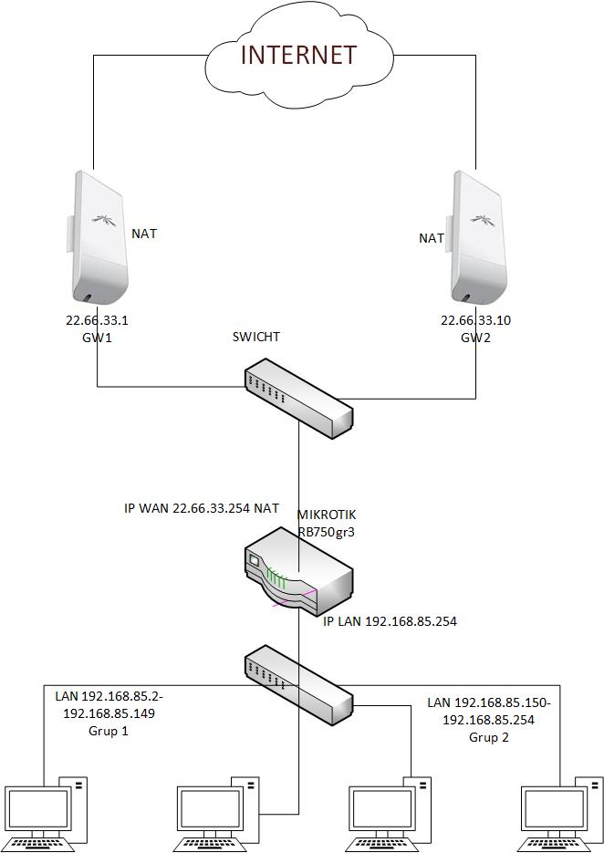

Hello friends, I’ll explain again to see if they understand me better, I have a group of users on the 192.168.85.0/24 lan that I want to separate into 2 groups but that they remain within the same network segment, so I want to make a group that contains the users from 192.168.85.2-192.168.85.149 and another group from 192.168.85.150-192168.85.253, the first group I want to leave by the gw1 which is 22.66.33.1 and the second group that leaves by the gw2 22.66.33.10. both gw enter by the same port wan not by separate ports, I do not have any extra configuration in the mk, I have it restored by default without loading the basic configurations.
Thanks for your help.
Here is a basic diagram of how my network is
If each of the two Ubiquiti Nanostations has a different public IP on its internet-facing interface than the one it has on its Mikrotik-facing interface, and uses src-nat when sending packets to internet as the picture suggests, then OK, responses to packets which went from your clients to the internet come back via the same Nanostation through which their respective requests did. So this is not the root cause of your issue.
So please post the output of “/export hide-sensitive” from your Mikrotik as otherwise there is no chance to find out where your problem could be.
