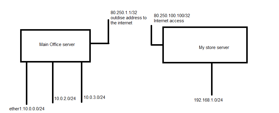

I have created Site to Site IpSec Tunnel
(like shown in the guide - https://wiki.mikrotik.com/wiki/Manual:IP/IPsec )
everything is working
now I want to add to to Office1 another netwrok 10.1.203.0/24 that will be on ether3
how can I do this?
I have done the same setting (like I did for the first network ) on both side but I don’t get any replay
why?
can it been done even?
what do I need to change in order to make it work?
Thanks ,

I have a server in office1 and a server in office 2
i don’t think it make any sence to make tunnels for every network I have in the main office…
isn’t the all idea of IPSEC? to make 1 secure tunnel ?

I want to be able to go from my store server to all the networks in the office
when I use IPSEC I can only get access to 10.0.2.0/24
what I need to do ??

which network shuld I need to right in each end?
now I have all 4 networks in both ends
do I need to wirte in each end the networks on the other side OR the one on my side?

I have look again and saw this:
in “Main Office Server” I can see in IP-Route the Store netwrok - 192.169.1.0 reachable
in “Store Server” I can see it added the 3 networks but they are all unreachable
so I guess this is the prblem…
any idea why?
where can I search the problem ?
