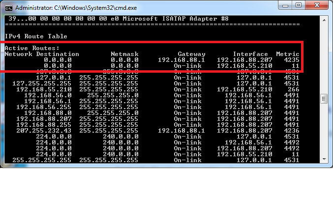

Add the route in the client. Not in ppp.
In windows it would be route add 10.0.0.0/8 10.0.0.1
In your client routing table, if it has the vpn as the default gateway it should have something similar to this, where 192.168.55.254 is my vpn local address. See how the metric has changed to prefer the vpn for default gateway vs local, which in my case is 192.168.88.1.
If you add the route to the client (10.0.0.0/8) it should look like this, and then you have a route to the 10.0.0.0/8 devices local to that router.

add address = 0.0.0.0 / 24 gateway = 0.0.0.0 netmask = 24 ‘’ ‘’ ‘’
It’s not necessary! We only record the current subnet (10.0.0.0/24..or another)… either one or several, depending on how much is needed. The link I copied where L2TP configs were displayed had one subnet and nothing more. With this configuration, everything will work without problems
If he changed his ppp network addresses like provided in the screen shots, thats why he can now get to his existing 10.0.0.0/8 subnets attached to the router. The reason he couldnt before is because he was trying to overlap his ppp and local to the router subnets, which is why I suggested changing to an unused subnet such as 192.168.255.0/24, or one hes not going to otherwise use. As also suggested above, I was able to use proxy-arp on the bridge and get to the subnets while overlapping, as also suggested above.
I believe the reason the latter didnt work for him, is because he also manually assigned an ip address on the client, which may or may not have matched where the router was attempting to send for its ppp client.
Now you will need to protect your router, and set appropriate firewall rules.
