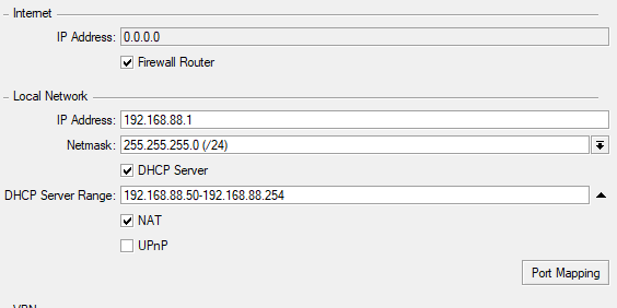

Use Quick Set like example: http://forum.mikrotik.com/t/lhg-lte-kit/142863/1
This should and provide PIN for SIM and APN of course.
This should in 95% give you internet even at connected devices.
Some ISP in USA can create problems but in EU this is all you need to start use device.
Give logs and screenshot if you have problem.

I can now connect through a Three sim card after following the guide posted above many thanks.
But i wanted to test an ee sim also before I decide which one to use permanently however when I test an EE Sim it does not work.
It does not show an internet IP address which I think might be the problem,
Again any help would be very much appreciated again.

This setup should give IP Address in range 192.168.88.50-254 with gateway 192.168.88.1.
You cannot connect to RouterOS via IP: 192.168.88.1 ?
Check if you receive that IP by windows cmd: ifconfig /all
You try WinBox or www interface ?
Run WinBox and show what you see at Neightbors tab.
Cmca say:
Three sim - I understand that is a name of your ISP/MNO
EE sim - it’s your next ISP/MNO then use his proper APN to receive internet.
