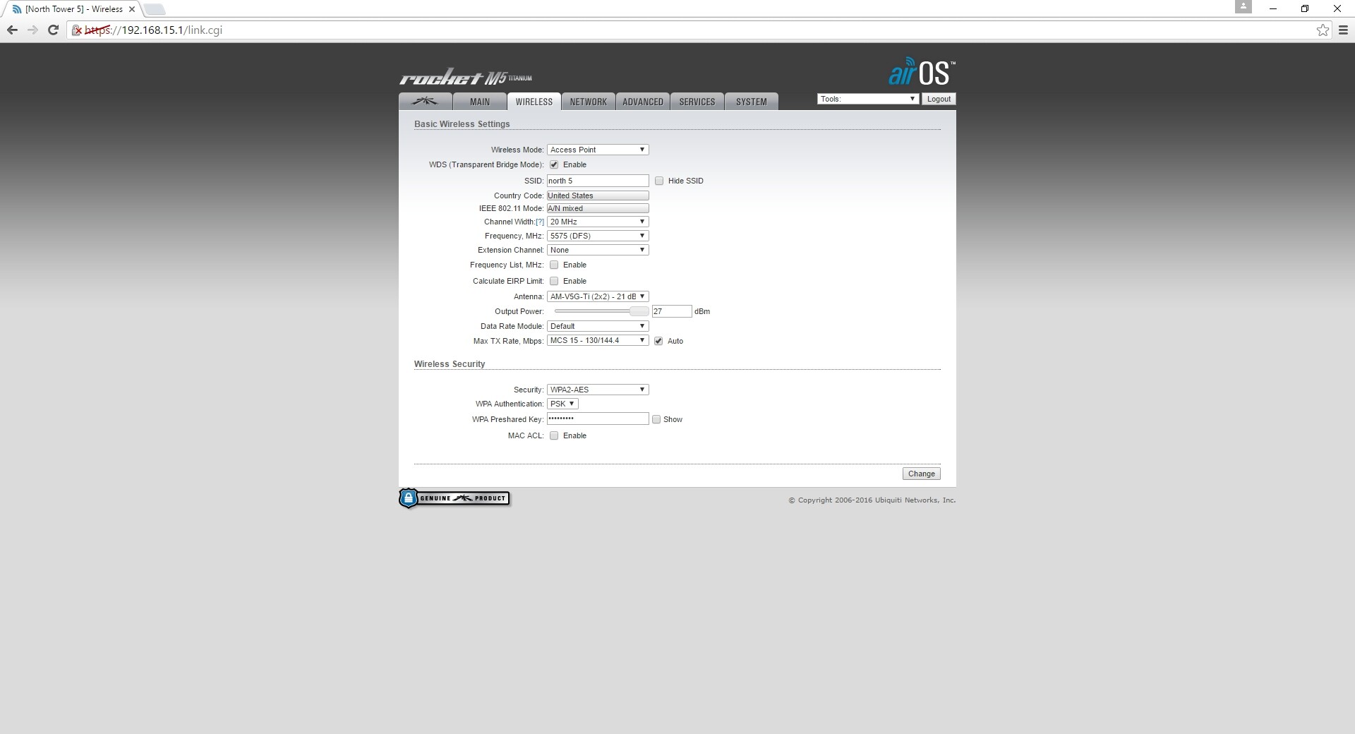

For starters, the WISP here was suffering from major lag. The owner tried some things before asking me for help because I’m an IT guy at a hospital. (servers more than network) Still, I took to google and found out some things. The big issue I ran across was that the different receivers (sometimes called towers) were using channels that were really close. I found the frequency settings, divided them by 9 and had the owner manually set the channels as far apart as possible. This seemed to stop the collisions and got the internet much more stable in recent days.

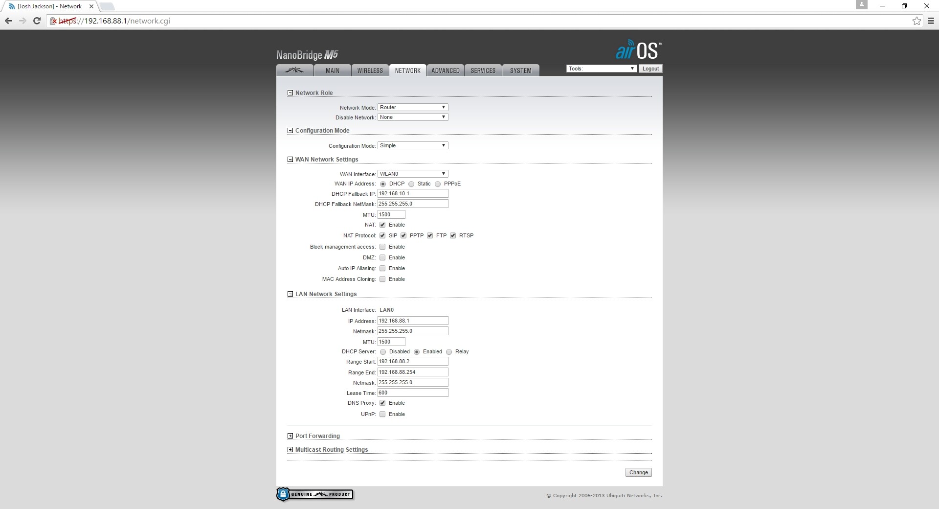

Now, in our journeys, the Fiber provider in another town gave some tips like disabling NAT in certain points, I experimented with the WDS mode which seemed to help, and notice our core switch is in bridge mode. These are all things I’m wondering how to optimize which is why I’m posting. I’ll include some screenshots of each device, and hopefully some of you can fill me in on what would be optimal for the service. The first screenshots I’m posting are for the transmitters. These are in each individual home that’s subscribed to the WISP. They look more like a power adapter than an actual modem I’m used to seeing.

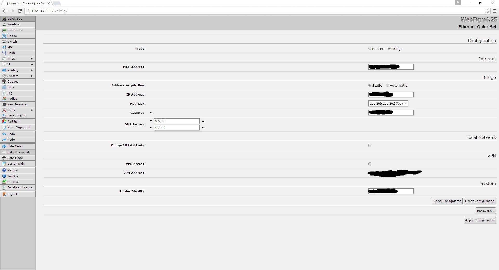

Yeah, you guys are really funny. Pride and joy of internet communities. Thought I made it pretty clear I’m a IT GUY, which means I’m no way qualified to handle this. I happen to be the only guy who does and can though. I also mentioned I would post more screenshots because my initial post would only allow two for some reason. We have airOS devices that go to a Mikrotik core router. I’m hoping to find some useful advice because I live in a tiny, rural Colorado community and have little to no help in this area. Sorry for scouring your forums and actually thinking you guys might be helpful. Anyways, here’s the some core router settings. I’ve figured out the collision problem that has helped the web traffic, but online gaming still lags and drops intermittently. We’re using an RB1100AHx2 router and while the CPU usage hovers at 10%, I noticed the RAM usage seems to be full all the time. Could that cause a problem? Anything in the core router that could be causing lag, specifically for gaming while causing erratic speed tests (works fine, can’t connect, extremely low speeds, etc)? Here’s the quick set settings, happy to add more stuff if I know where to go.

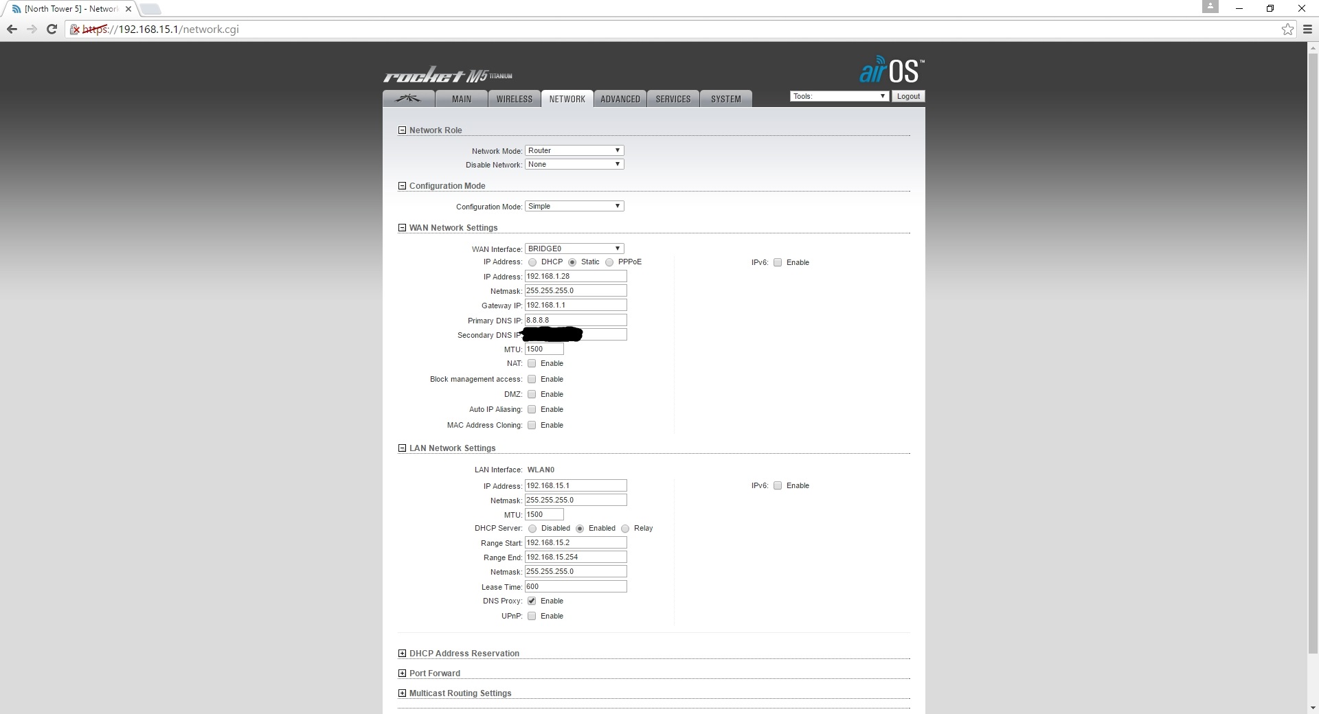

Here’s some of the receiver settings. Let me know if the simple routing settings are too complicated for people who understand core switches. =)

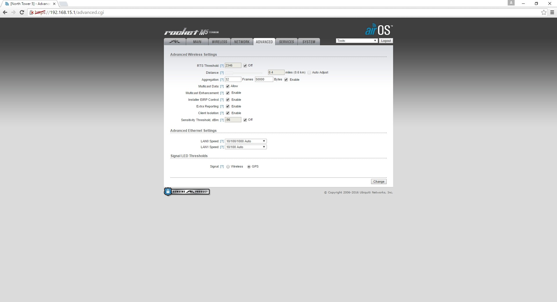

Last thing I have is some advanced settings that seem optimized enough, but I literally have nothing to lose posting them here so why not.

First of all quickset of isp core router showing bridge mode is nonsense. The quickset itself is nonsense. Put here export if you would like to show us something.
You haven’t told us the topology so it doesn’t matter how in details are set other ubnt things. Strange you do routing there…
Natting in inner network? Why are you doing it?

That said, each house has a dish that shoots to a tower above town. That tower has 9 receivers that are connected to the Mikrotik core router. That router is connected to a fiber line provided by an internet company from a neighboring town. We have around 500Mbps down and up, but only seem to use roughly 250 down at peak times. I don’t know if that explains the bridge mode or not, but I hope it helps to some degree. It seems we need some form of NAT for the internet to work. For instance, if I disable NAT in my airOS transmitter in my house, while it’s disabled in the airOS receiver on the tower, my internet goes down.

Maybe you can help with these two questions. First, is bridge mode good for a core router, or should it be set up in router mode when it’s being used for internet service? Second, our CPU usage is nice and low, but it seems that the 1.5 GB of available RAM is always full. Can that cause latency? I can easily convince him to upgrade the router, but won’t unless I’m sure it will help. The software on the RB1100AHx2 only allows for 1.5 GB so I can’t upgrade only the RAM.

SO! How about a screenshot of the MAIN tab of the UBNT radios (better yet post it on the UBNT forums)? I really don’t expect it to be an issue with the configuration of routing, briding, NAT, etc. The 1100AHx2 should have no problem bridging 500Mbps. BUT IT IS POINTLESS TO USE A 1100AHx2 AS A BRIDGE AKA SWITCH. Still, test it by wiring directly to it and see what you get. The WISP guys here are all just WTF’ing at the extreme amounts of NAT you have going on - in most environments public IPs are given out to customers.
Since you are using UBNT radios, I suggest you go to the Ubiquiti forum to ask, but you are effectively looking for some simple things - SNR (noise floor (dBm) - signal level (dBm)) should be at least 20 and ideally better (take away the (-) sign when doing that) for decent connections. Run the built-in spec analyzer at both the AP and client to see what interference there may be. If there isn’t any and your SNR is 20 or better, you shouldn’t be having it that rough.
Another critical aspect is if you have a bunch of poor connections on an AP, the AP will spend more time sending the same amount of data to those clients than those with good connections, stealing time away from those with good connections. One GREAT way you can deal with that on a UBNT AP is setting priority on the clients with good connections to something better than NONE. Read the AirOS userguide it has a lot of useful information.
There is nothing wrong with taking a look at things with no experience - obviously how else are you going to learn. Just try not to do it haphazardly.. I see the channel and TX power on your AP is breaking regulations if you’re in the USA - there’s a 30dBm EIRP limit on DFS channels, you’re at 48 if you indeed have a 17dBi sector.
