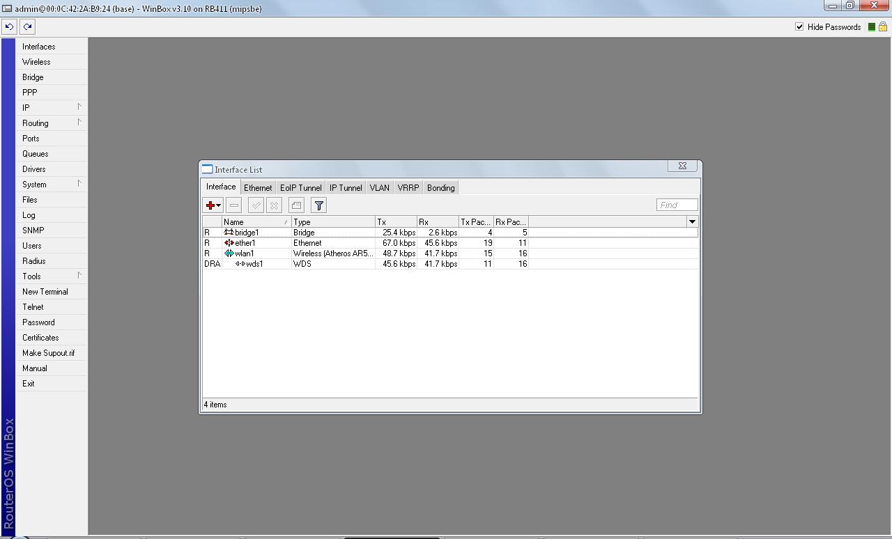

By the looks of it you are trying to set up a transparent bridge between the two networks? That is in the wiki, under transparent bridge.
I think that you have made a mistake. Your first radio should be in ap-bridge mode to make a WDS System.

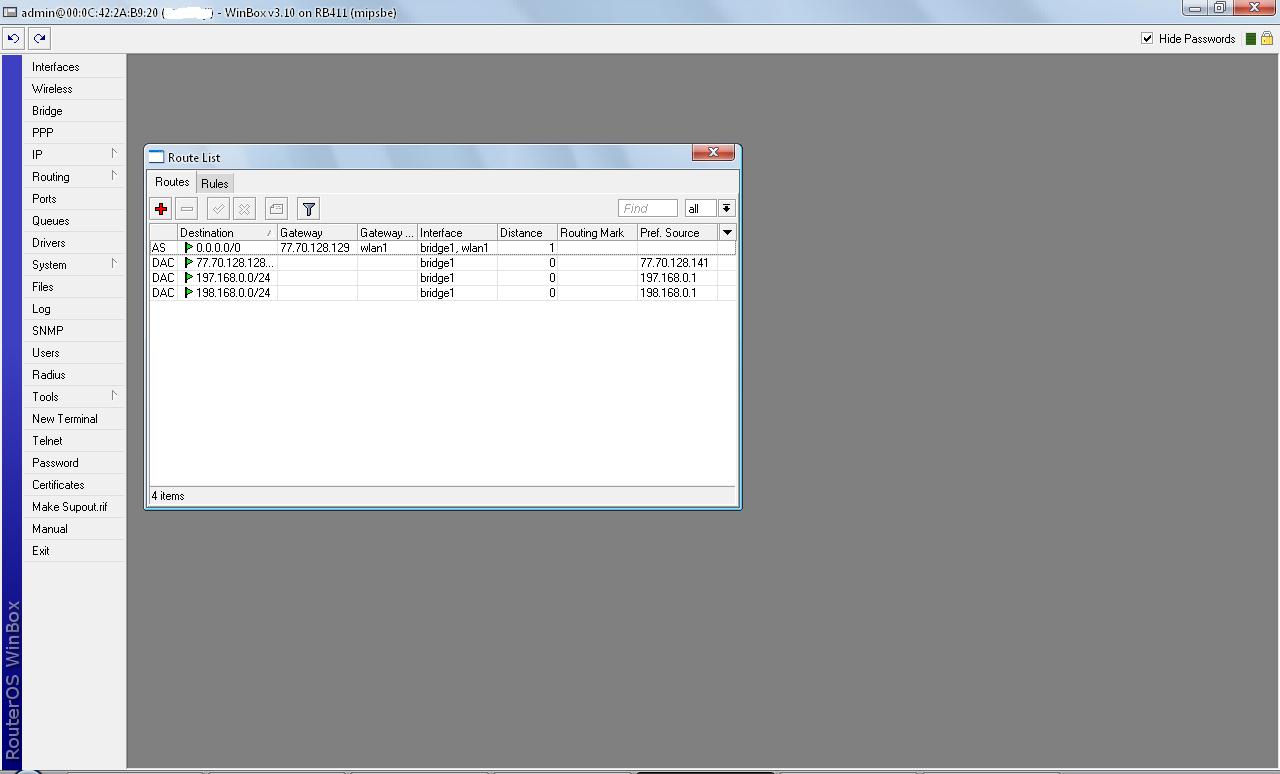

Actually I have done this with 2 level 3 licenses. Both sides in bridge mode and wds them transparent ptp link.
No One has answered my question yet. How do i make the computer in the remote office browse the internet with d same static ip of the one i have in the switch of my base radio. assuming the static ip on the switch is 198.123.123.24/26 network.
thanks
Did you follow the Wiki?
http://wiki.mikrotik.com/wiki/Transparently_Bridge_two_Networks
Just ignore the part about IP addresses, it’s written wrong in the Wiki. But for a transparent bridge you don’t need IP addresses on the routers.

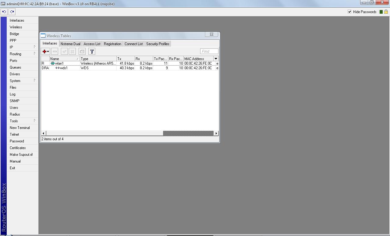

Station wds-mode should not be enabled.
To browse - ip of the remote office needs to be on the same network as base.
