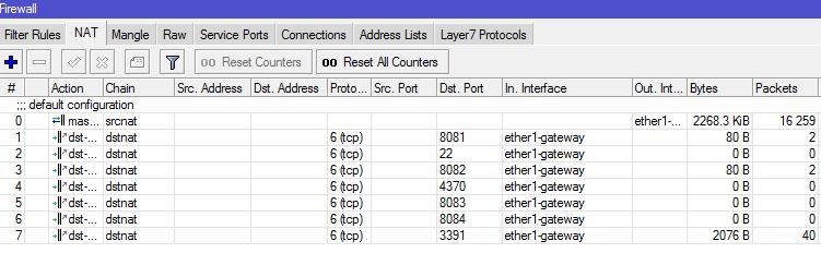

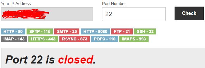

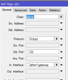

hi. how to forward port 22
i have a ubuntu server connect ssh 192.168.1.91:22
its no work
I’d first be checking to ensure the firewall isn’t blocking connections on that port. Check if you can connect to 192.168.1.91:22 from inside your lan?
Try changing your NAT rule, General > DST-PORT to 9022, and leave internal port in Action as 22.
See if you can connect on port 9022 externally.
inside no problem
Disable any firewall rules that may be dropping packets.
