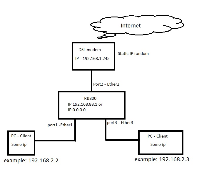

Somebody can help me please with RB800 routing I have v4.14
I don’t know how to route as i say I’m new there.
I need setup DSL modem with mikrotik and from mikrotik i need connect two PC’s
how to do this?
Thank you!

How is your provider giving you ip address? through DHCP?..if this would be your option, you would have to configure into your wireless or ethernet interface a DHCP CLIENT like this
/ip dhcp-client add interface=ether2
If you have to provide statically an ip address this should be your configuration
/ip address add address=192.168.1.244/24 interface=ether2
After this you would have to creat an static route to route all the traffic to your gateway
/ip route add gateway=192.168.1.245
then you would have to setup your DNS
/ip dns set servers=8.8.8.8
I am taking the google dns for this example
try with either one of those configuration and from the router New Terminal ping http://www.mikrotik.com and see if that resolves
check that out and first get connectivity inside your router and then we will procceed with the rest of it
