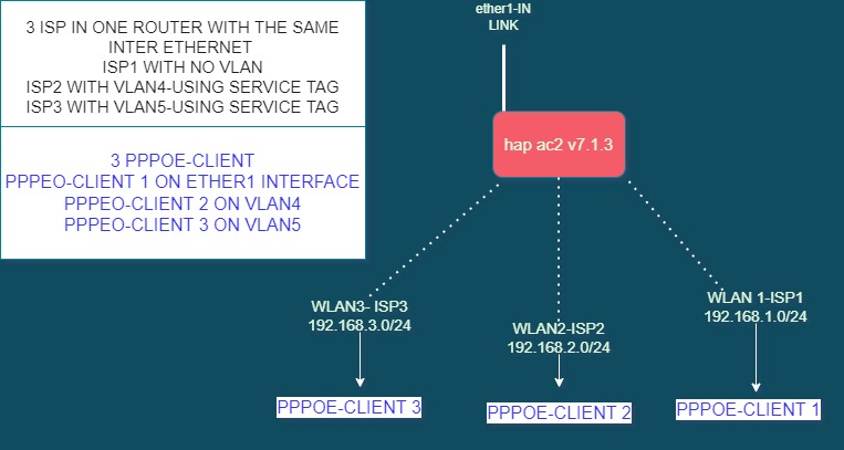

after greeting, please look to the fiqure first in attachment
i have one mikrotik router with 3 different isp i did the routing by route each lan to specific wan(pppoe)
LAN 1 TO WAN1

thanks for answer ,i tried to do one pppoe and one lan its work all fine with no problem i need to know how to force the in and out packet and traffic to go to some specific wan without any overlap and any missing in lan to wan traffic by the firewall and the mtu is not 1500 just in the first pppoe1 which is on ether interface and i dont think that is the problem
OK. So since you want to completely separate the routings between each PPPoE client and its corresponding LAN interface from each other, what about using VRF to assign the routing marks, rather than mangle rules?
