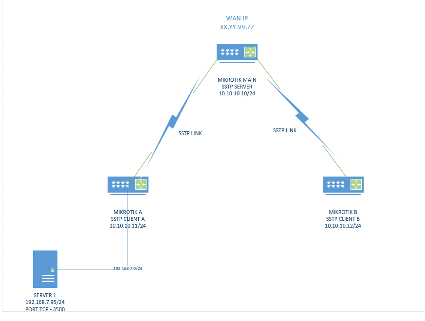

Simply i have 3-4 locations and i need to access servers when i am outside of company network. From any point of network location i can access to all servers. But at one location i dont have public ip and i need to access there when i am outside.
How should i write routing path for both side to gain access to my server from wan? For example if i am accessing to
xx.yy.vv.zz:4000 - Mikrotik should route me to 192.168.7.95:3500
Here is simple schema. Any help or idea appreciated.
On Mikrotik Main i have these rules for this.
add action=dst-nat chain=dstnat dst-port=4000 in-interface=WAN protocol=tcp to-addresses=192.168.7.95 to-ports=3500
and
add distance=1 dst-address=192.168.7.0/24 gateway=<sstp1>
Thanks for advance!

The problem is most likely with reply packets. If you just forward port from Mikrotik Main to Mikrotik A and keep client’s original source address (i.e. some random public address), server sends reply there (that’s fine), but Mikrotik A won’t sent it back to tunnel and instead will use its default gateway and it can’t work.
You need to either mark (on Mikrotik A) incoming connections from tunnel and then mark routing for replies, to use different routing table with default route going to tunnel.
Or if you don’t care about seeing real source addresses, then just masquerade connections on Mikrotik Main:
add action=masquerade chain=srcnat dst-address=192.168.7.95 dst-port=3500 out-interface=<sstp interface>

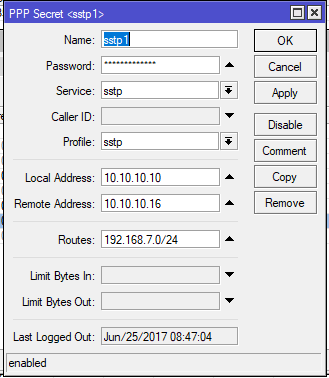

  1. Create two PPP secrets at your main location; one for each site
  2. Pick a range of IPs not in use, it appears that is 10.10.10.0/24 for your.
  3. Assign each PPP secret a local and remote address so the MikroTik has a unique IP for each remote site. Alternatively you can assign a remote-address to each via a pool.
You will then have the necessary meat to get your site-to-site connections working. In addition you can use the routes function to set routes dynamically into the main site for each of the remote site’s local networks that will only appear when they are online. This can be used in place of dynamic routing especially if you are setting a default route in the PPP client to send all traffic over the tunnel back to the main site.

Actually my settings are same as you explain. Here is my ppp secret :
As i said before, from inside network, everything is working. I can access site to site - site to Main Mikrotik. But i need to access Mikrotik A over Mikrotik Main, since i dont have public ip for Mikrotik A.
