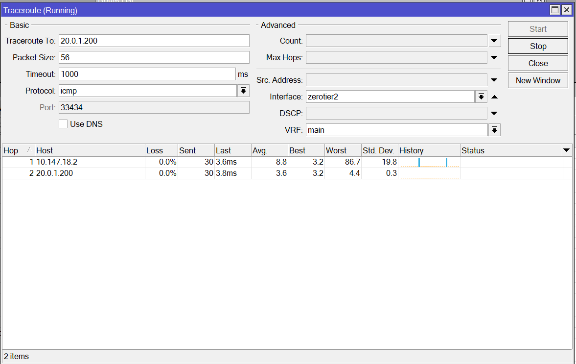

I am having an issue where if I ping / traceroute from 10.147.18.4 on the hAP ac^2 to 20.0.1.200 it works and I get a reply.

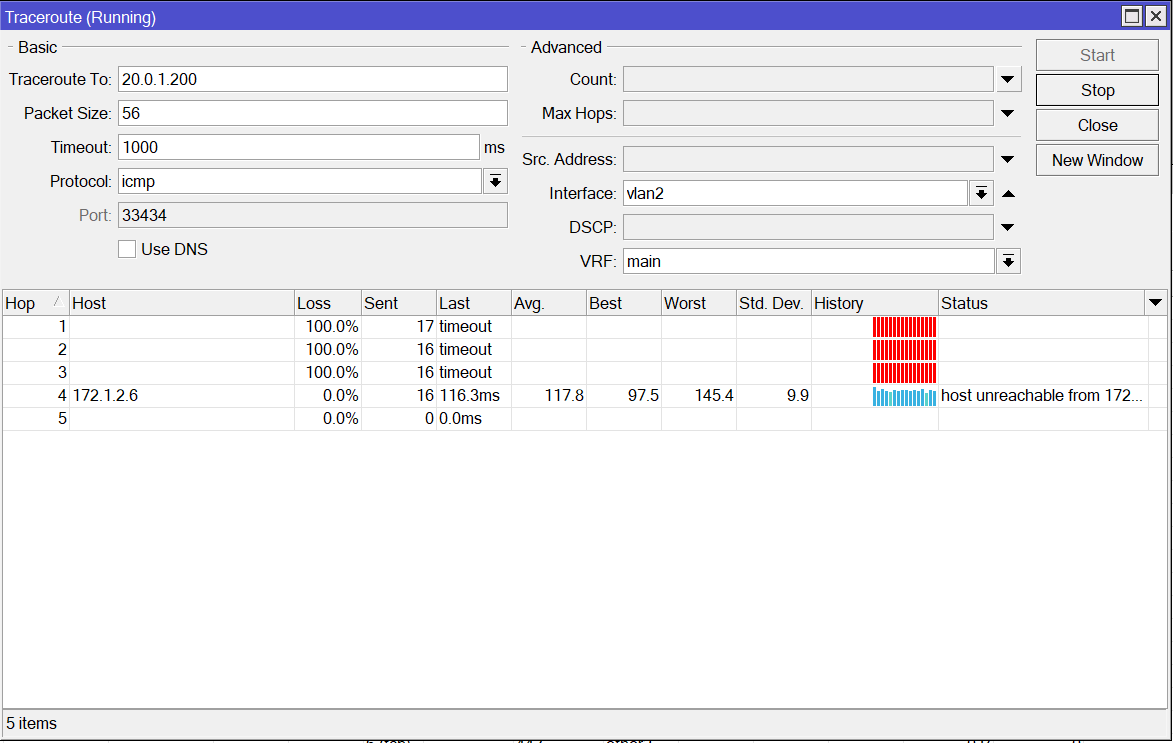

If I ping / traceroute from 172.1.2.6 on the hAP ac^2 to 20.0.1.200 it fails / host not found.

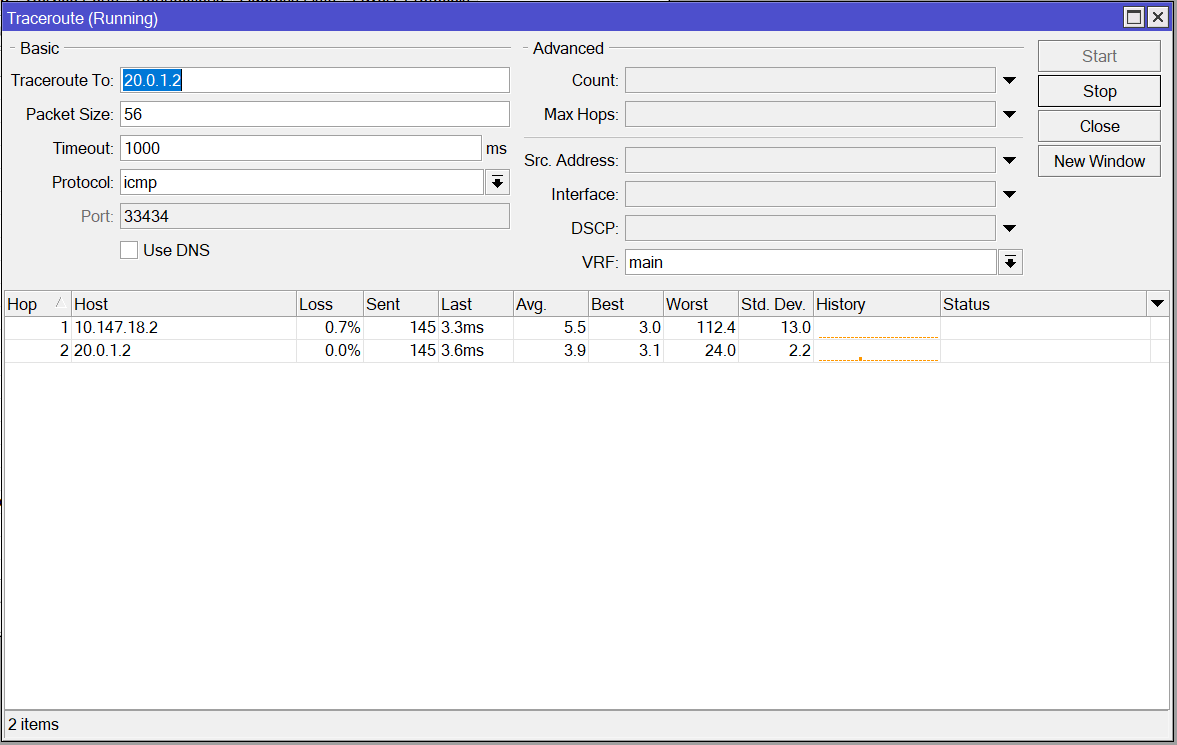

Please see traceroute screenshots below.
Have you checked the firewall rules? The routing on the second router?

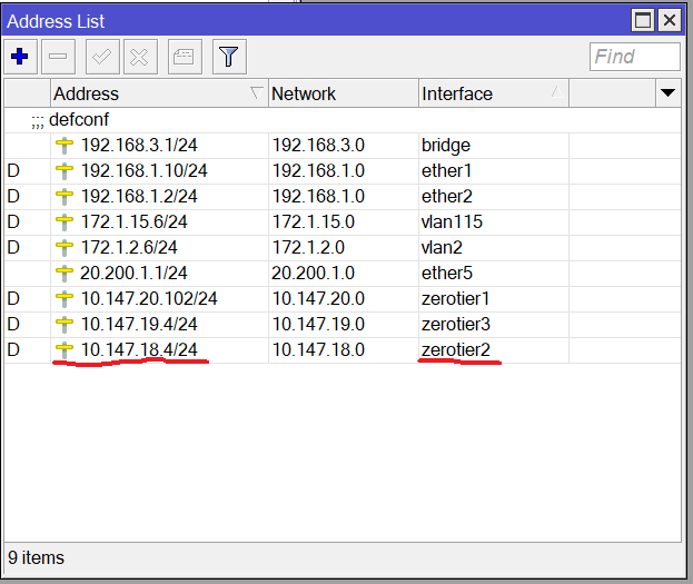

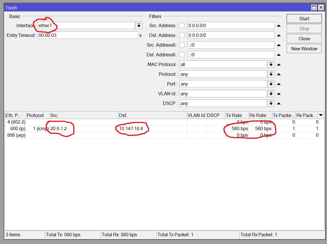

This is a trace route from hAP^ac2 to the main router. The trace route is run from the zerotier interface on hAP^ac2 to the host machine on port 7 of the main router. As you can see, there is a route, and it carries traffic.

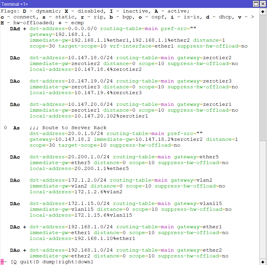

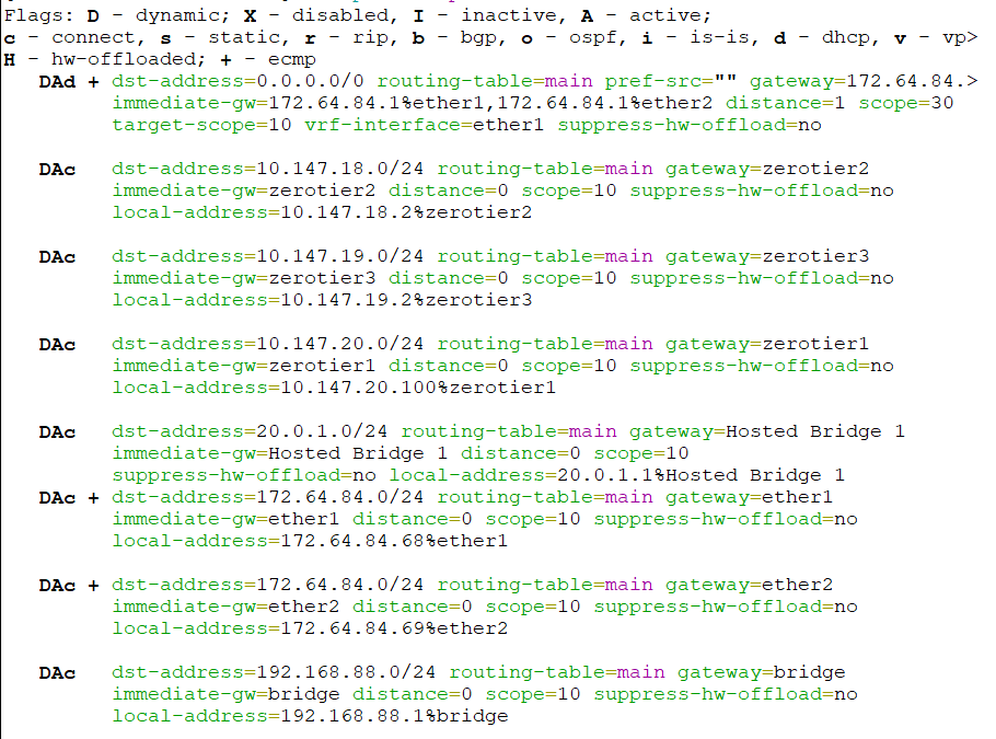

Send me the routing table from both router. That will be easier. “/ip/route/print detail”

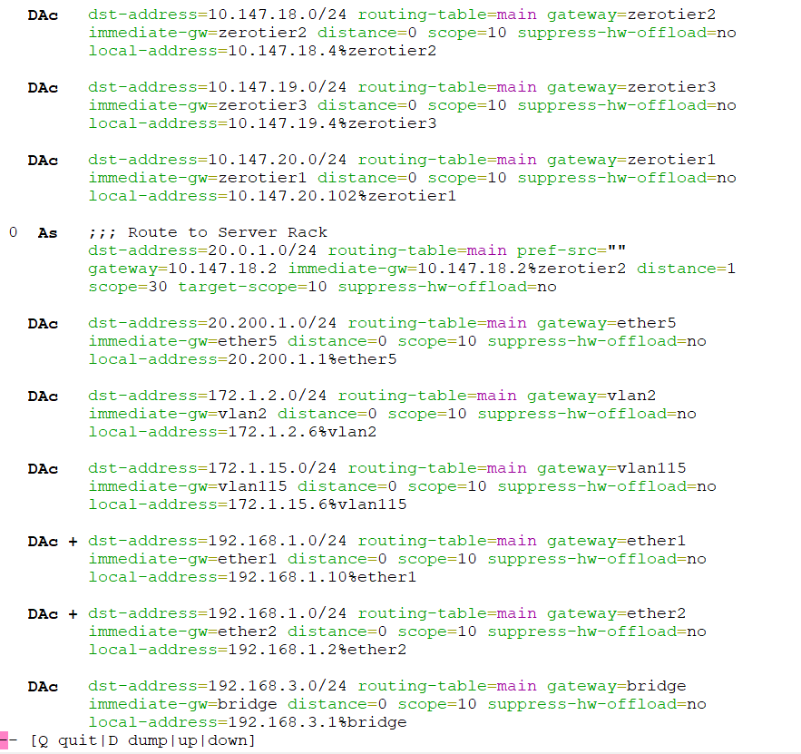

Here are screenshots of the routing tables.
Main-router has no return route for 172.1.2.0/24.
On main-router, add a route for 172.1.2.0/24 via 10.147.18.4. You also need to check your zerotier and make sure that network is defined.

What I don’t understand is if I run a traceroute on my hAP ac^2 and tell the traceroute to use the zerotier interface, it works correctly and does not have any issues, but as soon as I change to a VLAN or ether interface, it does not work, and that does not make sence to me.
If the nain-router doesn’t know where 172.1.2.0/24 is, it can’t reply.
So fix that, prove me you fixed it and we can continue.
