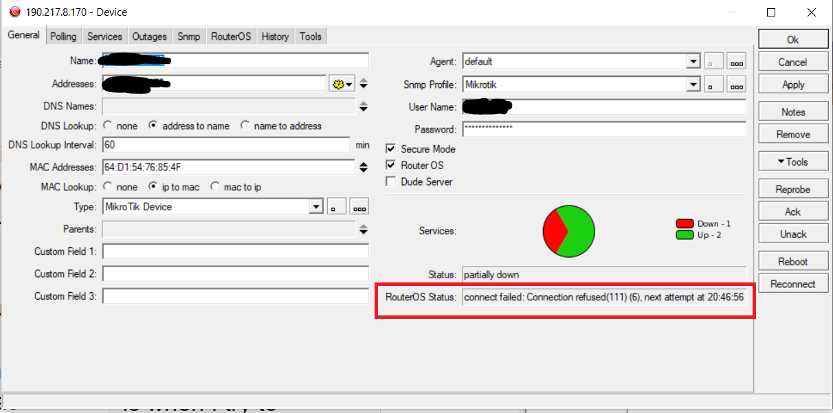

I have a problem with The Dude, I need to manage, monitor and even update my mikrotiks with this monitor but I can not establish connection with the device, every time I try to reject the connection throwing this error ("connection timeout (6), next attempt at 15:59:28 ") I have read several forums and also seen tutorials but still the connection is not established.
It should be noted that I am using the correct ports and my devices do not have firewall rules that interfere with the connection.

Hello, my equipment is routed locally, I can add the equipment without any problem to the dude and consult snmp, ping among other qualities, my problem is when I try to connect the dude to an MK either to update or manipulate it.
It gives me error as in the image that I show you, it should be noted that my IP address, user and password are correct and there are no firewall rules that prevent the connection
Go to services and tell me what service is down…
Does the user you are using to login have “dude” permission?

Check that your device’s firewall accept connections on default winbox port 8291 from the address of your dude server.
I already have a rule that accepts all the protocols and ports of the server dude network
Is there anything valuable in the device’s logs when dude is trying to connect?
Does winbox run on the default port?
Can you confirm with torch, that dude packets are reaching the device?
