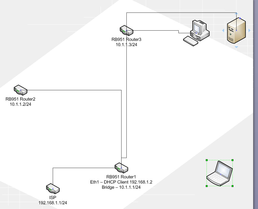

Hey guys,
This is my setup.
See - attachment.
I want wireless Staff and Guest.
I want security.
I want other not able to see my network.
point me in the right direction or if you have a similar code/situation, please help.
Thanks in advance.

Is the first router(1) the only router and the others are acting as access points and switches??
Why do you need multiple router boxes? I have one Mtik router in my office with multiple vlans. APs are mikrotik and unifi. Switches are mikrotik and unifi as well.
One vlan for office, one for guest. One cannot see the other once they are segregated via vlan with proper firewall rules.
Yes, he is routing, while the other two act as AP and switches.
Router 1 is on ground floor, router 2 is on first floor, router 3 is on second floor.
One AP would not be enough, considering the house is huge and reinforced concrete walls do not help with signal boost ![]()
So, router 1 is main router, has DHCP Server and NAT, while the other routers act as AP and switch.

Just point me in the right direction for how to make two different VLAN’s on three same RB951.
Sure thing…
This is your best resource!!
This has some useful info as well.
https://wiki.mikrotik.com/wiki/Manual:Bridge_VLAN_Table
